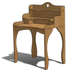

I had a small space when I was at college in my dorm and a very limited budget so with I set myself a budget (£100) and measured the space I had to fit the finished table. The maximum width i had was between a wall and a wardrobe which measured 830mm. I decided then that the overall width of my finished piece would be 800mm.
In order to keep cost to a minimum too, I decided I wanted to make the entire piece from a single 8 x 4ft sheet of 18mm Plywood. I had hoped to make it from Birch Plywood but as the cost of this material was so high, I had to settle for a lower B grade.
The CAD drawing shown above is of the final design i came up with. It has been slightly modified from the piece I produced as after I made it, my neice said she would like one also so I added a curved top and a small heart. I think this makes the piece a bit more feminine and more interesting for someone of her age (11).
Step 2: CAD and Layout
After i went through the various sketches and designs I found a design that fitted my requirements and also one that fitted onto a single sheet of Plywood. I managed to pull a favour from a friend within college who knew how to operate the CNC machine so cutting the pieces out was achieveable, as long as I could produce a 2D dxf file for him to input into the CNC software. The picture above is what i sent him and so the cutting began
