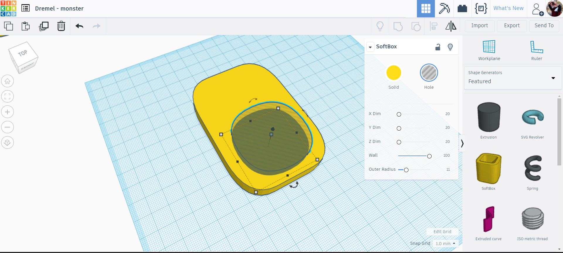

I really like the rounded corners of the softbox, found in the Shape Generators dropdown under "all".
![](https://content.instructables.com/F4V/8LQA/JLQUUV9G/F4V8LQAJLQUUV9G.jpg?auto=webp&fit=bounds&frame=1&height=1024&width=1024)
It comes in with an opening through the center, but by using the slider on the "wall" option the inside can be completely filled. I then stretched the softbox to the shape I wanted my monster.
![](https://content.instructables.com/FBD/4IR7/JLQUUV9H/FBD4IR7JLQUUV9H.jpg?auto=webp&fit=bounds&frame=1&height=1024&width=1024)

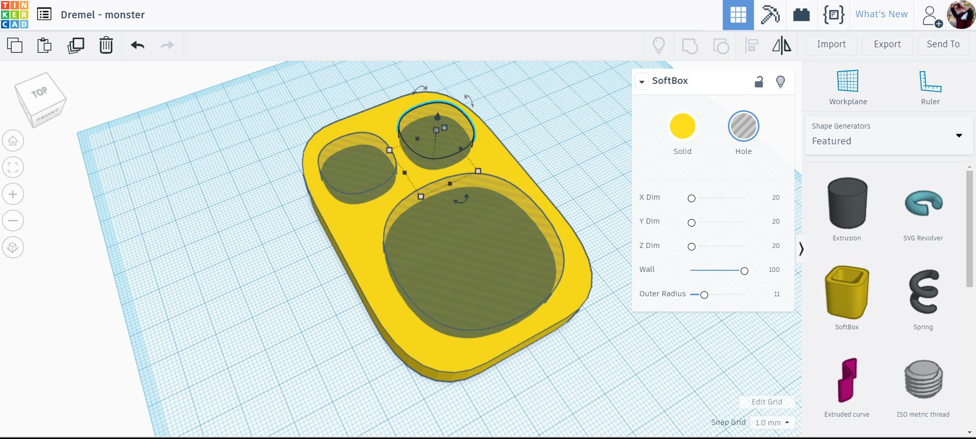

I used another softbox to make the openings for this monster, changing the shape from a solid to a hole. The wall slider was also moved to fill in the insides of the shape.
![](https://content.instructables.com/FQ4/JO1W/JLQUUV9I/FQ4JO1WJLQUUV9I.jpg?auto=webp&fit=bounds&frame=1&height=1024&width=1024)
I made one opening for the mouth, then two smaller ones for the eyes. Using the align tool fro mthe top toolbar allows the mouth to be lined up perfectly with the body shape. The eyes were placed one at a time, with the second one being duplicated (ctrl+D) from the first and then slid over while constraining the movement with the shift key to keep it in line.
Once everything is in the right place, select the pieces and group (ctrl+G) them together to make the top of the stacked monster.
