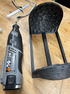

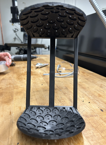

Let's first 3D print the levitator base! You can find the .stl file underneath. The CAD model is for half of the levitator, and you can print it twice and glue them together to make the levitator base. Alternatively, if your 3D printer is large enough, you can duplicate the model in your CAD editing software and print the levitator as a whole. The model is from UpnaLab - BIGLev using 72 16mm transducers.
After printing the levitator base, clean the edges and the sockets. We needed to enlarge our 144 sockets using a Dremel, because the sockets in the CAD model did not exactly fit the transducer legs. Make sure to attach a small Dremel head and drill through each socket to enlarge it.

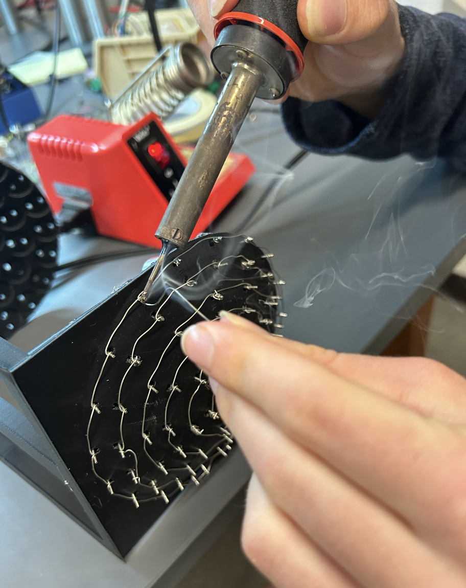

Step 4: Wire and Solder

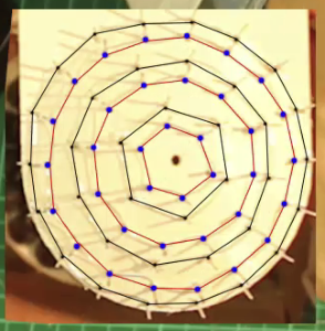

Use a bare wire to wire each array of transducers (36 of them) in 6 different rings. The first image from UpnaLab illustrates the wiring. The red rings connect to one leg of the transducers and the black rings connect to the other leg. Solder all the pins to the wires.

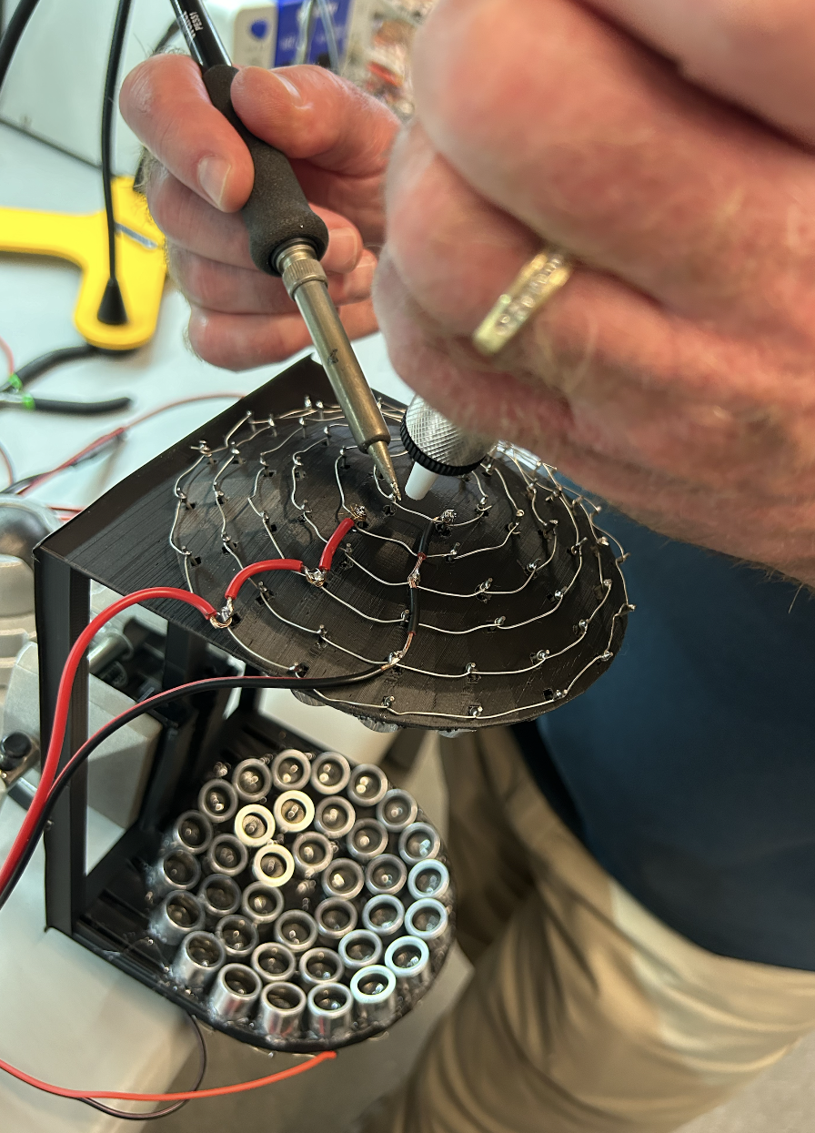

Step 5: Parallel Transducer Circuit
Prepare 4 long wires and solder them to the transducers according to the image above. Make sure to cut and expose 3 segments for each long wire, and solder those exposed segments to the pins. This makes the 36 transducers in an array all in parallel.

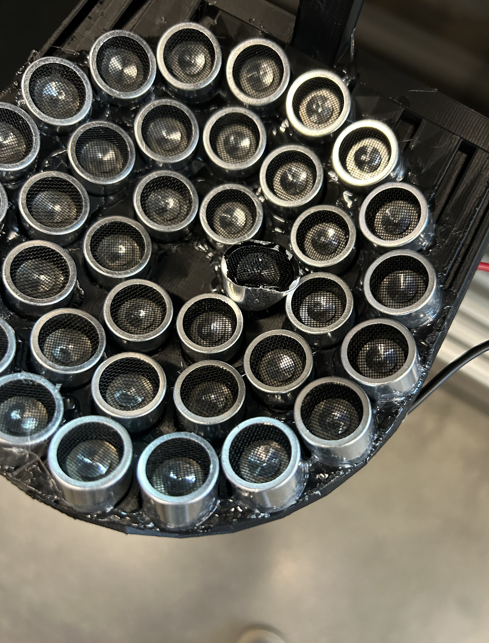

Step 8: Test Transducer Phases
Every transducer in the same array should be in phase with each other. The two arrays should have opposite phases.
Hold two receivers (microphones) with two channels on the oscilloscope. Put one receiver directly on top of one transmittor on the levitator, and the other receiver directly on top of another transmittor. The receiver signals on the oscilloscope should be in phase for every transducers in the same array. The two arrays should be 90° out of phase with each other.
If there is a transducer with the wrong phase, you can desolder its wires, take it out with pliers, reverse the direction, and re-solder it. The above image shows us desoldering one transducer and taking it out.
