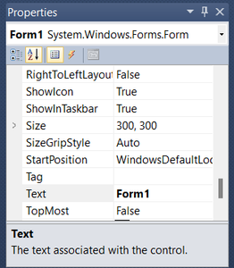

Step 3: Resizing Your Form
Now, while Pong itself is quite antique at this point, we did in fact develop bigger monitors over the years, so lets use that extra real-estate.
In the bottom right corner, you should see a menu labeled properties, and while scrolling through it, you'll find a property called Size. The default is a measly 300 by 300, That is a bit small, so lets size it up. Click on the property and change it to 1300 by 500 (1300, 500).

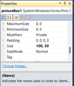

First, lets start working on the top and bottom boundaries. To the left of the screen, you'll find your toolbox. Inside, instead of your typical Stanley 25' tape measure and miscellaneous nuts and bolts, you will find such things as Labels, Picture Boxes, Buttons, and so on and so forth.

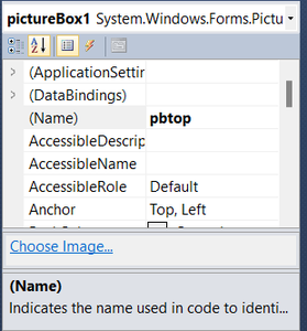

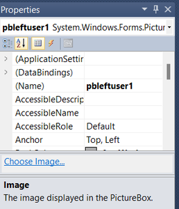

For now, we will be sticking primarily to Picture Boxes. Double click the button labeled PictureBox and it should drop one in your form.

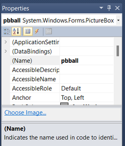

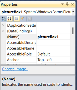

Now, one thing to keep in mind is organization, especially with Names. Names, act as the addresses inside the code. While you may be able to keep track of 100 picture boxes inside your head, I cannot. So lets rename it.
For ease of use, we call Picture Boxes "pb" and then whatever their purpose is. For instance, the top picture box acting as a boundary will be called "pbtop".

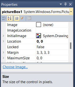

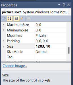

Next, we'll want to bring the picture box all the way across the form. Inside the properties menu you will see a property labeled Size. The default is (100,50), but we will want to change that to (1283, 10). While the form is (1300, 500) it has margins that must be taken into account, that is why it is 1283 instead of being 1300. Keep in mind, those numbers are the equivalent to coordinate points, and are based off the top left of the picture boxes.
You will also want to make sure the location of the picture box stays at (0, 0).

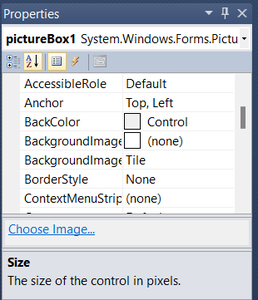

Finally, you will want to change the color of the picture box. You will want to click on the property labeled "BackColor" and you will then be greeted by another menu with a bunch of beautiful colors such as ActiveBorder and AppWorkspace. Now, these are not actual colors, you can find those within the submenus labeled "Custom" and "Web", these colors are just named this way because that is how they are used within C#. For this project, I decided to go with AppWorkspace, also known as gray.
There you have it, a gray bar across the top of your form. Isn't coding exciting?

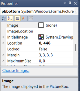

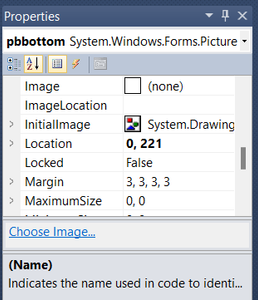

Step 5: Another Bar

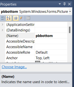

Now. while you could in fact go through the steps of making another picture box, resizing it, and giving it a new splash of paint, we have copy and paste for a reason. While having the picture box highlighted, click Ctrl+C on your keyboard, and then Ctrl+V. This should cause a second picture box to appear!
Remember to rename that magically appearing bar to pbbottom.
The default location for this bar should be right in the middle, right where we do not want it. So lets change it from (0, 221) to (0,446).

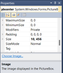

Step 6: Center Divider

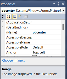

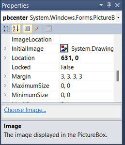

Again, let us just copy and paste the top picture box, rename it pbcenter, as it will be going in the center, change the Size to (10, 456) and the location to (631, 0). Looking pretty good so far!

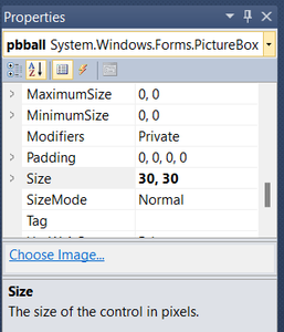

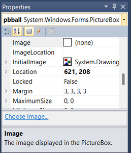

Step 7: Pong Ball, While Not Actually Being a Ball.
Now, while the astute amongst you would like to point out that our ball, is not in fact, a circular shape, and is instead, a square, the reason for that is because at this point in the course, we have not been taught other shapes besides rectangles, as in picture boxes, and with this project, I would like to keep it within the boundaries of what we have been taught. Now, onto our ball.
Again, as in the previous steps, copy and paste one of the bars, rename it to "pbball", set the Size to (30, 30) and the Location to (621, 208). The end result after all previous steps, should be a sideways H with a square in the center.

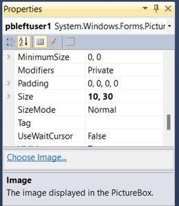

Step 8: Left Paddle
One of the difficulties I had while coding this project would be that of how to make the ball bounce at various angles, depending on where it hit the paddle. My solution, would be to make multiple paddles! This line of reasoning will make more sense once we get to actually typing out code.

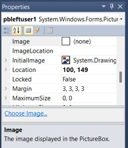

Copy and paste the ball picture box once more, name it "pbleftuser1", set the size to (10, 30) and the location to (100, 149). Now, as you may have noticed, there is an extra 1 at the end of that name. That is because each paddle, is actually made up of 5 picture boxes, labeled 1 through 5.

Now, as some of you look at my numbers closely, you may realize that while the picture boxes are 30 units long, they are not equally set apart 30 units. This is because C# has it so some of the picture boxes have a slight gap between them at 30 units apart, so you have to squish them together a bit. Does this affect the actual execution of the project? No. Is it annoying, so much so that I had to change it? Yes.

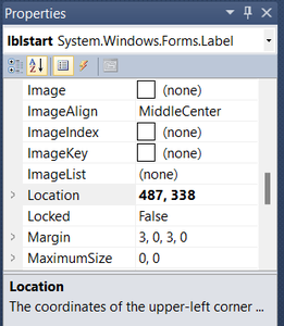

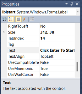

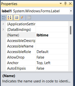

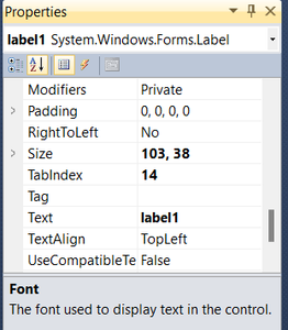

Step 10: Labels

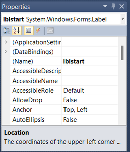

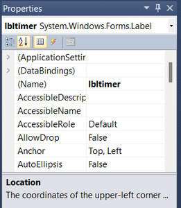

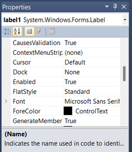

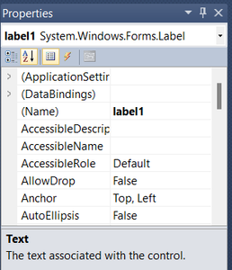

So, labels. Labels allow you to add text to your form, which we will be using for the timer, scorekeeping, and telling you how to start the game.
You will wanna go back to your toolbox and double click on Label, which should drop one inside your form.
As with picture boxes you name them "pb" plus whatever their job is, you do the same with labels, calling them "lbl" instead. For this first label, we'll call it "lblstart".

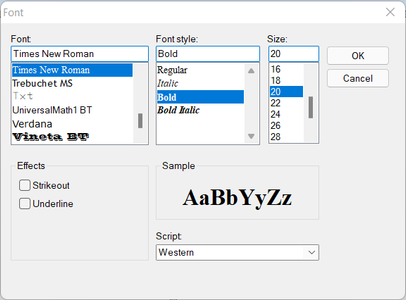

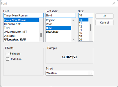

A new property which labels have and picture boxes don't is the Font Property. Within here, you can change the font, the font style, and the size. For this label, we'll set it to Times New Roman, Bold, and 20pt font. We will also set the location to (487, 338)

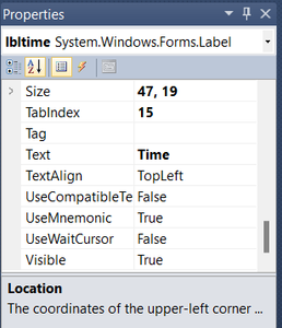

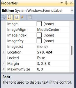

Step 11: Time Label
Lets start working on the timer section down at the bottom. We will create one label to the left side of the divider and one to the right to actually display the time. Create a new label and name it "lbltime". Set the font to:
  • Times New Roman
  • Bold
  • 10
Set the location of this label to (578, 424) and set the Text property to "Time".

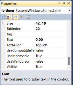

Step 12: Time Label: the Sequel

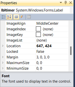

Oh boy, the sequel! Hopefully it lives up to the original, but we all know sequels are just a cash grab.

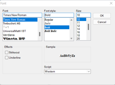

Anyhooo, create another label, name it "lbltimer" and set the font to:
  • Times New Roman
  • Bold
  • 10
Set the location to (647, 424) and change the Text to "0:00".

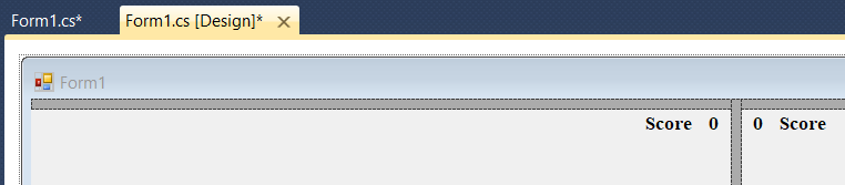

Step 13: Scoreboard
For this section of the game, create four labels, two for both sides
  • Name: lblleftuser
    • Font: Times New Roman
    • Style: Bold
    • Size: 10
    • Location: (550, 13)
    • Text: Score
  • Name: lblleftuserscore
    • Style: Bold
    • Size: 10
    • Location: (607, 13)
    • Text: 0
  • Name: lblrightuser
    • Style: Bold
    • Size: 10
    • Location: (671, 13)
    • Text: Score
  • Name: lblrightuserscore
    • Style: Bold
    • Size: 10
    • Location: (647, 13)
    • Text: 0
If everything goes well, it should look like the above image. If you are having issues, please refer to previous slides.

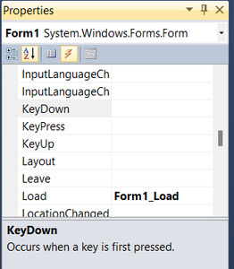

Step 15: Form_Load
Please copy the above code into the form_load section by double clicking on the form
Now, in this section, when a form is loaded, these lines of code are fired.

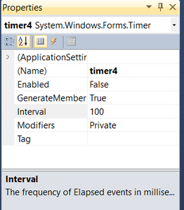

Inside your toolbox there will be a submenu labeled components. At the very bottom there is an item called "Timer." Bring four of those into the form. They should appear at the bottom, 1-4.
Inside the property menu for timers, you have Name, Enabled, GenerateMember, Interval, Modifiers, and Tag. For this project, we will focus on Name, Enabled, and Interval.
Name, is the name of the timer, the address essentially.
Enabled is whether or not the timer is ticking.
Interval is the interval at which the timer ticks. It is in milliseconds, so 1 second would be 1,000 milliseconds, and 1/10 of a second would be 100 milliseconds.
Adjust the four timers accordingly:
  • Name: timerleft
    • Enabled: False
    • Interval: 10
  • Name: timerright
    • Enabled: False
    • Interval: 10
  • Name: timerbounce
    • Enabled: True
    • Interval: 10

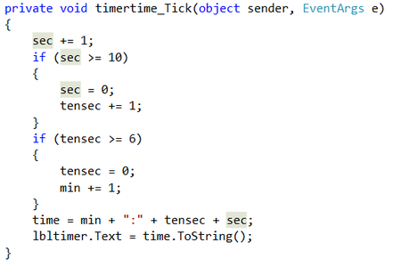

  • Name: timertime
    • Enabled: False
    • Interval: 1000
There we have it, the four timers we will need for our project

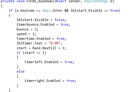

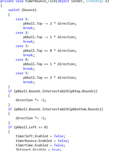

Step 19: Timerbounce
Please copy the above code into the bounce timer.
A new function we are using is case break. How this function works is it takes the variable (in this first vase, bounce). In our last timer, we had the each paddle intersection equal to a bounce, 1-5. 1-5 are the cases. When ending a case, you put "break" to break the line of code.
As you can see, if the ball touches a higher or lower paddle, it moves up or down by two pixels for every timer tick. The center paddle however, makes it go straight outwards.
We then have our Intersection code for the top and bottom picture boxes. When the ball hits the top or bottom, it multiples the direction variable by -1 to change the sign of the variable. This in turn with our previous case break code, allows the ball to be able to bounce all around the screen.

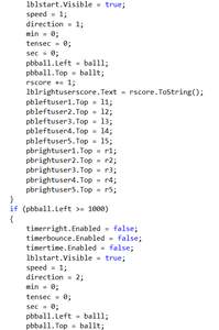

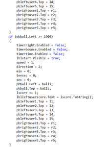

The next section of code is our scoring code. If the x-value (or left value) of our ball is less than 0, the right user wins. This in turn turns off all the timers, makes the start label visible once more, lets the speed and direction back to 1, turns our time variables back to 0, and adds 1 to the right user score.
lblrightuserscore.text = rscore.tostring();
This line of code turns the rscore variable into a string, which you can then use to change the text of the right user score label. For instance, if you scored once, your score would increase to 1, and it would set the label to read 1 instead of 0.
Also reset, is the positions of our paddles and the ball. Given that we took the positions of the paddles and balls when the form loads (in form_load) we can set their positions back to them by just setting the positions to the variables.
The last section of code is simply if the ball goes to the right side (greater than 1000) and the only true difference is the direction and the left score, which adds a point to the left user.
Step 20: Timertime
The final timer on our list is the one in control of the clock. Please copy the above code into the timertime timer.
Now, every time the timer fires, 1 is added to the sec variable. When sec is equal or greater than 10, it resets sec back to 0, and increases the tensec variable by 1. Then in the next sequence, if tensec is equal or greater than 6, it is reset back to 0 and 1 is added to the min variable.
Then we take our time string and set it equal to:
min + ":" + tensec + sec
This takes our variables and organizes them into a sequence that will resemble a typical analog clock.
We then take our time label and set it equal to our time variable so that it gets displayed.
Step 21: Key_Down
Lets get going on the user inputs.
Go back to your Form Design page (Form1.cs [Design]*) and go to the form property tab. Click on the lightning bolt and scroll to the property called KeyDown. Double click this property and the coding window should pop up. When a key is pressed, it is sent through here.
Copy the above code according to the pictures.
The first button we will focus on is the Enter Key. We will also be looking at If Statements.
If the event within the paratheses is triggered, it runs the code below it.
if (e.KeyCode == Keys.Enter && lblstart.Visible == true)
This line of code takes the keycode and sets it equal to the enter key. You may also notice the double &&. That makes this If Statement an And Statement as well. So, if both events are triggered at the same time, the code is fired.
lblstart.Visible = false;
timerbounce.Enabled = true;
bounce = 3;
speed = 1;
timertime.Enabled = true;
lbltimer.Text = "0:00";
start = Rand.Next(2) + 1;
.Visible code refers to whether an item is visible, or invisible. So, in this instance when the Enter Key is pressed, and the lblstart label is visible, it makes the label invisible. This line of code also makes the timerbounce enabled, so the ball can bounce around when it hits something.
It also sets bounce to 3, which according to our previous timer code, means the ball will travel directly along the x axis.
The random line of code spits out a number, either 1 or 2 (a random function generates a set number of units starting zero. So whereas the code would actually spit out a 0 or a 1, we add 1 to that to get our 1 or 2)
If the direction equals 1, it goes to the left. If it equals 2, it goes to the right.

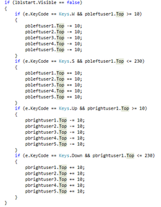

The next section of code is our paddle movement code. It is all contained within an If Statement, so if the start label is invisible, the other lines of code can fire. Now, if you look at each If Statement, you will notice that each one is an And Statement as well. If the top paddle of each side is below 10 or above 230, you can move the paddles up and down by 10 units. This is to stop the paddles from going off the screen. We also use the W, S, Up Arrow, and Down arrow (W and S for the left paddle, Up and Down arrows for the right)
