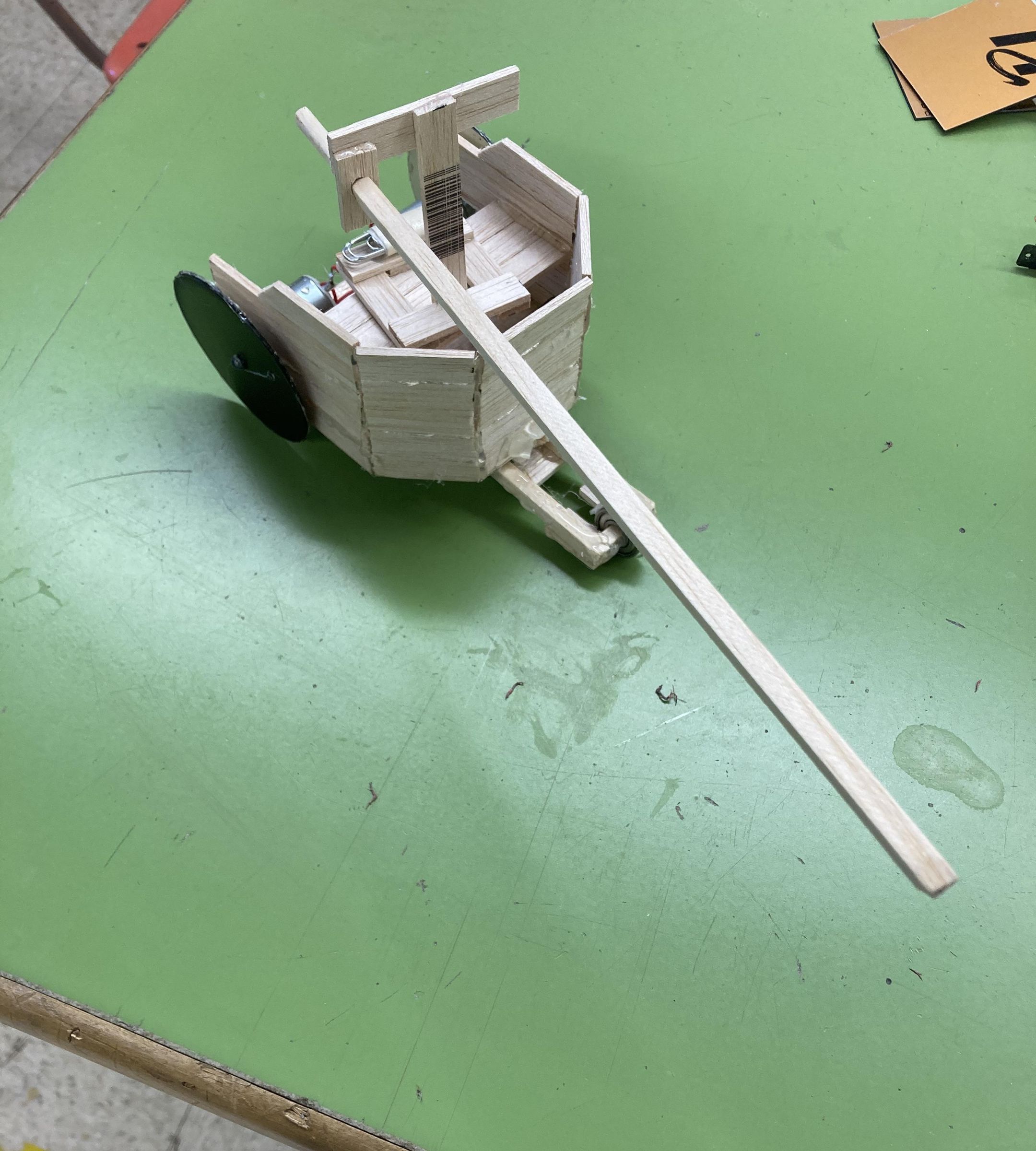

Four years I have done this competition. First year, I did a Raspberry Pi weather station with a partner. Second year, I did Chariots using simple circuitry. Last year, I did a coding project, that being Pong in C# Visual Studios. I hope this project shows the process, not just for the RC Tank, but the whole of my high school career doing this competition, combining single board computers, scale model vehicles, coding, and my newest skill: 3D Printing.

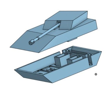

Step 5: Top Assembly
  1. Take your "Top" print, "Barrel" print, "Turret Print", the 2 "Lock Block" prints, and your Turret Motor
  2. Hot Glue the Barrel into the Turret
  3. Hot Glue the Lock Blocks into the Top in the two slots
  4. Glue the Motor so the shaft sticks out the hole on the "Top" print. Hot glue in place
  5. Flip it over, and slide on the Turret Assembly.

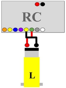

Step 7: Wiring the Motors

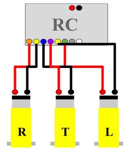

On the RC Receiver Board, there are 10 wires. The top two are for power (which we will get to later) and the bottom 8 are your channels. Now, when you receive your RC Board (if you get the same one I do) you will notice it has wires, and not Female Connectors. I modified my board early on when I first got it, however you can simply either solder the motor wires to those connections, use electrical tape, or add the Female Connectors like I did.

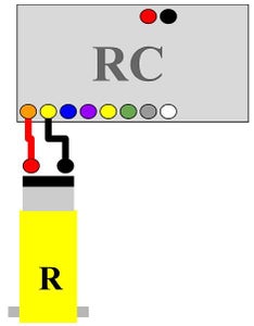

  1. With your Right Motor, connect the positive to the Left Most Connection (as indicated by Orange) and the negative to the one right next to that (as indicated by Yellow)

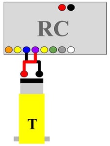

  2. With your Turret Motor, connect the positive to the 4th connection (As indicated by Purple) and the negative to the one to the left of that (as indicated by Blue)
  3. With your Left Motor, connect the positive to the 6th connection (as indicated by Green) and the negative to the one to the left of that (as indicated by Yellow)

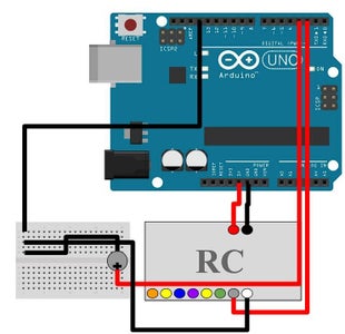

For this Step, we will add an Active Buzzer from the Arduino Kit to mimic a firing noise for the tank, and use one of our open channels from the RC Board to activate it. We will also plug in the RC Board so it has power

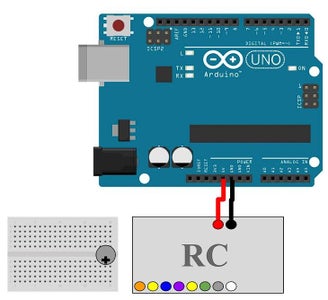

  1. Plug the Positive Cord from the RC Board into the 5V slot on the Arduino Board.
  2. Plug the Negative Cord from the RC Board into the GROUND slot on the Arduino Board.
  3. Put the Active Buzzer (positive away from the Arduino Board) into the small Breadboard.
  4. Putting a wire with the positive, place the other end into slot 3 on the Arduino Board.
  5. Put a wire with the negative, hook it into the opposite side of the breadboard.
  6. Take one of your last remaining channels from the RC Board and put in a wire, put the other end of that into slot 2 on the Arduino Board.
  7. Take the other channel and lead put it in the same row as the negative of the Active Buzzer
  8. Place another wire into that same row, and put it into a GROUND slot on the Arduino Board.
  9. Wiring is now done!
