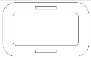

Step 1: Smartphone Support
Cut these 2 parts and glue them together.

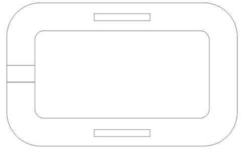

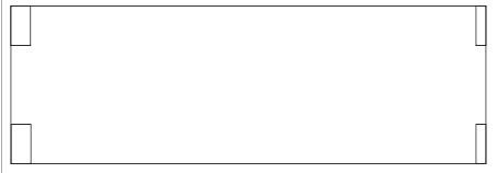

Step 3: Base
Cut this part for the base.

Step 6: Update
I added 1/2" slot for charging cable pathway.
Updated Corel Draw attached.

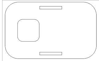

Step 7: Users Feedback Update With LED Holes and Narrower Base
From viewers feedback, I did some verification checks. The original simple design is working. However, not everyone has access to a laser cutter. Individual customization may be needed.
I verified that the legs, narrower base and cradle could fit FEDEX, UPS or USPS Flat Rate envelopes. I will add additional picture by tonight.
I added 0.5mm diameter holes to fit 3mm or 5mm legs. The holes are 0.1" apart.

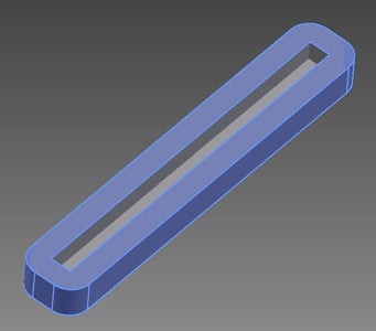

I added 3D Bracket Autodesk Inventor File that could be glue on current cradle and base. It would add height but making the legs shorter (better for shipping in flat rate envelope). Before you 3D print these parts, let me update you once the finished.. WIth the bracket, need for 3D laser cutter is not required. Just plain bandsaw would suffice.
Note that I did not apply the angle of the leg orientation. The 3D prints completed last night. I verified the CAD attached would work. I am not sure glue alone would be strong enough. 2 wood screws could be used if needed.

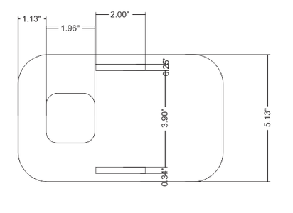

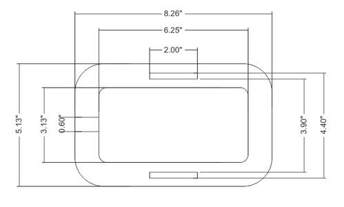

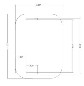

I added 3 photos with dimension. I was not able to save on pdf and verify if it could print with exact dimension.
