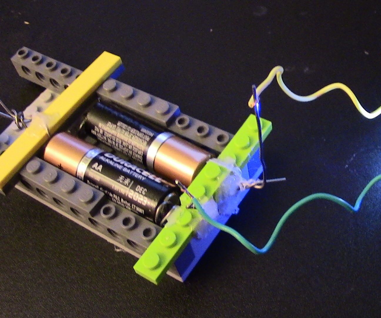

I am not a fan of buying things so I usually make from what I have. In this instructable I wired 2 four battery holder and 1 two battery holder all in series instead of buying a 10 battery holder. The best part is the holders are recycled from remote control cars.

Step 3: Connect the Battery Pack
Don't put your rechargeable batteries into the holder until you are done building the circuit. Safety first! :)
Solder the other diode lead to the positive battery holder lead. You may have to strip the insulation off the wire...
Next also solder the negative solar panel wire to the negative battery pack wire. Basically you have a solar battery charger now. The solar panel will trickle charge the batteries so you do not need a charge controller.
You can look at the wiring picture on page 1!!!
