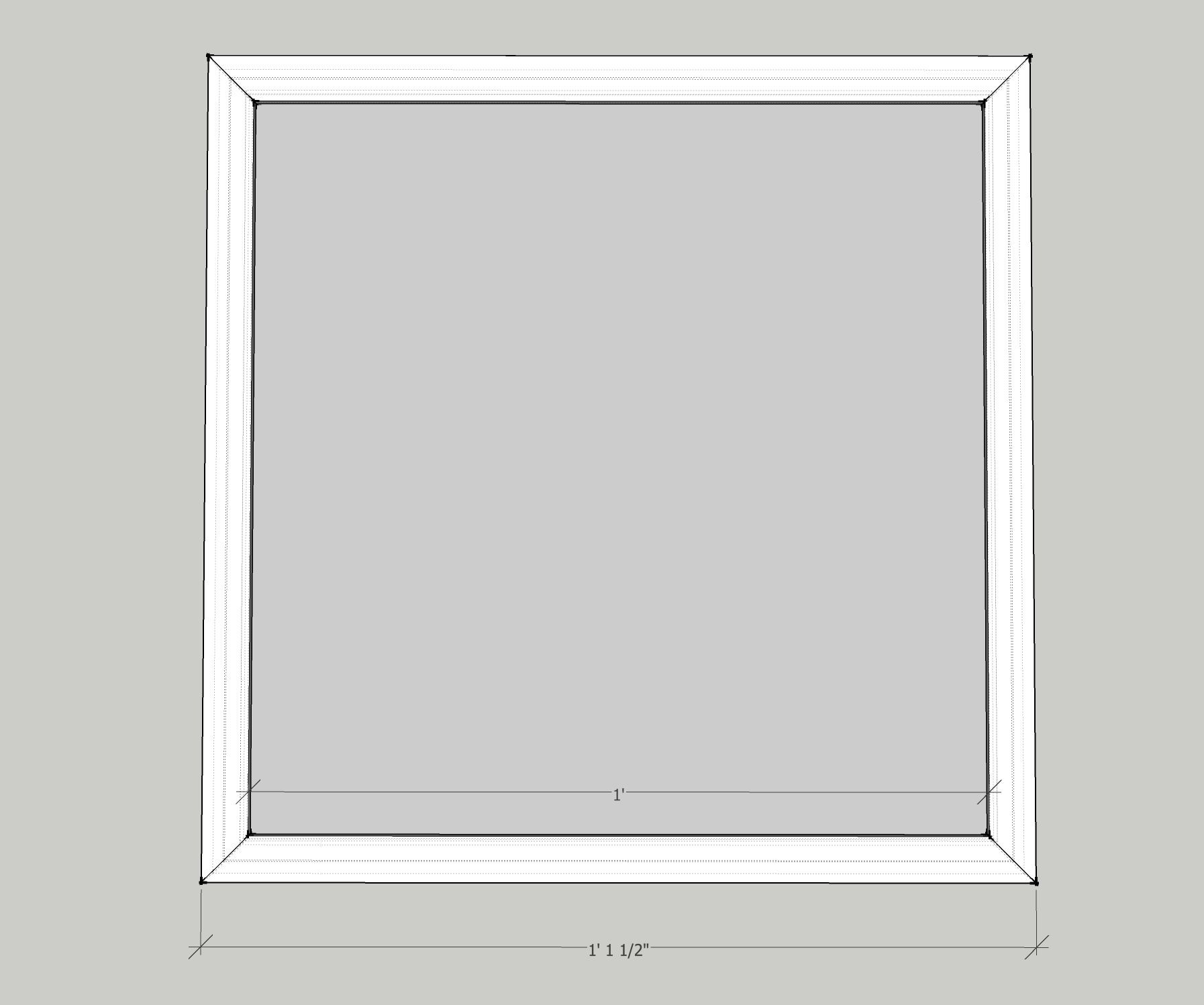

I do a lot of work in SketchUp, but since this is all custom stuff, I'm not going to upload the SketchUp file--it'll just be easier for you to start your own. And this would be a good project in which to learn SketchUp--all Rectangle and Push-Pull tools.
I started by "building" the cabinet, focusing on the interior measurements. Be sure to include the amount of overlap from the cabinet front, because you don't want your hardware to not slide out. In my case, the inside walls had a 7/8" overlap with the front, so I'll have to cut some 7/8" spacers to get the hardware flush.
Armed with the interior dimensions, I created my spacers, then another set of rectangle cubes to represent the sliders. I used the manufacturer's dimensions, because I ordered them online and they hadn't come in yet. I also decided to use 1/2" plywood, for cost and for size.
Once I had a width within which to work, I figured out what I wanted my frame to be. Some reconfiguring happened, because I wanted the front to be solid piece, instead of seeing the seams, which meant my dividers wouldn't be the same height (and hence, another ripping depth would be required.) Once I had a single shelf built, I grouped them together and copy/pasted to figure out how many I could fit.
At this point, I also built some rough approximations of items I wanted in the cabinet. In particular: a "tall alcohol" bottle (for the one or two liquers we have), the container in which I keep my flour, a tall spice jar, and the aforementioned panini press with plates, as well as the plastic wrap box. Once I had all of these things, I started to configure the approximate heights for the different shelves. The only requirements I had were that the panini press go on the bottom, and the plastic wrap go at the top of the bottom cabinet.
I can't tell you what your cabinets are, but don't think any measurement can be skipped over. I've been bitten enough by that already on different projects.
The final step I like to do is put out a 4x8' sheet of plywood, "disassemble" the shelf, and then see how much material I'll need, as well as what rips will need to be made. Check Step 4 for that image.
