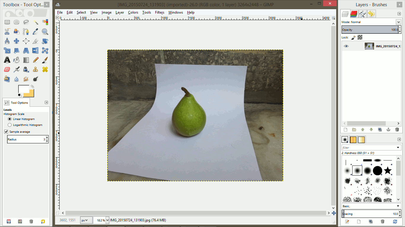

Step 7: Editing: Whiten
- Install GIMP. Open the image in it.
- Right click on the image layer in the panel on right and duplicate it(for safe-keeping).
- Select the topmost layer(should be selected by default after duplication).

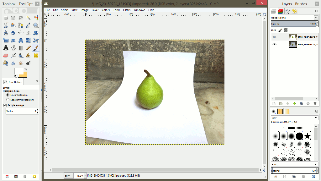

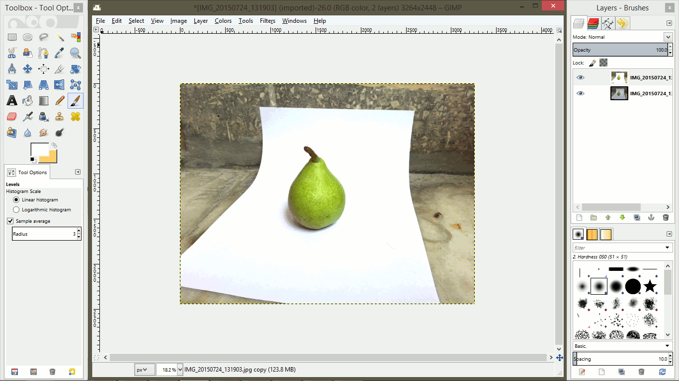

- Go to Colors->Levels.
- Drag the rightmost triangle under the graph towards left slowly. As it is dragged, the image becomes whiter.
- Drag till the area surrounding the object becomes perfect white.

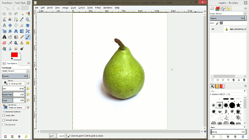

Step 8: Editing: Clean Background
- Select the paintbrush tool or just press P.
- Make sure Opacity is 100%.
- Select the hard round brush.
- Increase size to something comfortable.
- Start cleaning the area around the object till everything is white in the background.

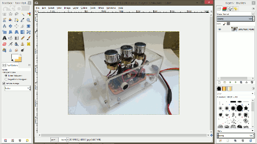

This is a slightly complex technique. When photographing transparent objects such as acrylic or glass, whitening the image also makes parts of the object invisible. This can be more or less fixed by using masking:
- Start by the duplicating the image as usual. The mystery behind image duplication will be revealed here.
- Go about the usual steps for whitening the image. You'll notice that when you try whitening the area around the transparent object, some of its areas fade to white and turn invisible. Don't fret about it.
- Click on the eye icon on the current top layer to hide it from view. You will see the original darker image.
- Select the other original layer so edits will be made to that layer instead of the new hidden one.
- Now whiten this layer as well. But choose to keep it slightly dark by opting for a slightly greater whitening value. I chose 170 for the first layer and 188 for this one. Make sure the previously invisible area is now visible.
- Unhide the top layer and select it.
- Right click on the top layer and select Add Layer Mask. A new white box appears next to the layer's thumbnail and is selected by default.
- In the window that pops up, select White (full opacity). Click on Add button.
- Click on the Paintbrush Tool.
- Select the softest round brush.
- Keep the brush size to a small value so you do not darken the area around the intended one by mistake.
- Set opacity to a value below 50%. 25% is a good safe value.
- Set foreground color to black.
- Zoom in to the invisible area you want to fix.
- Pass over the area to be fixed a few times with the brush. The hidden parts of the image will slowly appear.
- Zoom out and repeat for any other areas you wish to fix. I darkened the shadow a bit as well.
- Now select the layer thumbnail for the whiter upper layer. You will now switch from editing the layer mask to the image.
- Whiten the useless background areas as shown in Clean Background step. Remember to set the foreground color back to white, opacity to 100%, set the brush type to hardest round brush and increase brush size.
- We're Done!

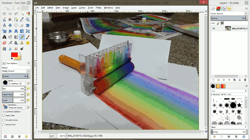

Step 12: Tip: Quick White Backdrop
You're in the middle of a project, need to take images of the current step but your project has become bigger or you need an angle which requires a bigger sheet of paper. But there's none available and a trip to the store means a break in the flow. Asking someone to bring it for you means waiting for them to return and til then unable to move to next step.
Here's a trick I found out for such a situation. Lay down multiple A4 sheets to create a bigger white backdrop. But there are a few things to keep in mind:
- the places where the sheets overlap, there will be dark lines. Make sure these dark seams aren't intersecting with your object. For that, keep the object in the middle of a single sheet and then spread others around.
- No part of the shadow of the object should fall on the seam. Cleaning up a line passing under the object is much simpler than one passing through a shadow. The shadow is a dark area and the line makes it darker. I've tried lightening, blurring, smudging but have been unable to remove these from shadows.
The second image shows these dark lines passing through the shadow. Since this was the picture mentioned before which I took without much thought but found appealing later, I didn't really look at this aspect until I reached the editing stage. As I only had one shot of this angle(the alternative being filling up roller with paint again and setting up the shot again), I tried slightly lightening the lines. But the lines in shadow are clearly visible.
