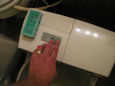

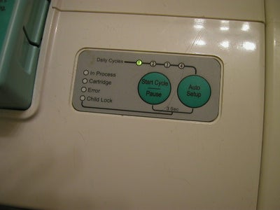

How To Enter Diagnostic Mode:
  • Unplug the CG.
  • Push and hold both buttons on the control panel.
  • Plug the unit back in, holding both buttons.
  • Hold both buttons about six seconds - until you see the lights on the control panel finish the normal power up sequence that you always get when you plug it in AND it starts a new sequence of flashing and beeping. NOW you can let go of the buttons.
  • If you did it right, the "4" will light up, go out and then the "1" will light up. All other lights will be off.
  • Congratulations, you're ready to get your diagnostic on!
To Select a Test:
Press and release the Auto Setup ("AS" from now on) button. This will advance to the next test. Test numbers are designated by the 1 - 4 lights across the top. More than one light might be on at a time.

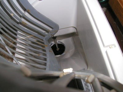

Step 7: Test 1 + 4: Draining the Bowl
Let's say you've got a CG that's full of nastiness and there weren't any beeps or anything to let you know. It has happened to me. You clear the drain line of any possible clogs - but then what? If all you want is to drain the muck so you can get on with fixin' el problemo, this is your test. Press SCP to start the impeller, press it again when she's empty.

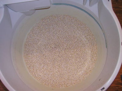

Step 8: Test 2 + 4: Blow Drying
Press SCP to start the blower and heater, again to stop. Put your hand in the airflow to see if it's getting warm or not.

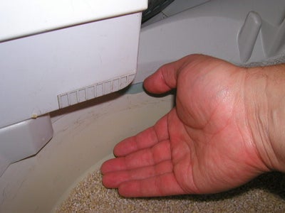

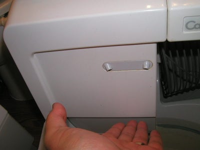

Step 10: Test 1 + 3 + 4: Sensor Test
Press the SCP button ... and nothing happens! That's okay. This test is for the "occupied" sensor eyes on the front of the processor.
Ever been using one of those fancy public toilets with the electric eye, and had it flush on you out of the blue? This sensor prevents that from happening to your cat when he/she is doing what cats do in litterboxes.
Pass your hand slowly across in front of the sensors, and the 3 and 4 lights should come on/flicker and then go out. Light 2 will stay on for one minute, then extinguish itself too: sensor checks ok!

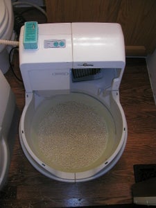

The CG also has multiple modes which can come in very handy. Let's say you had a cycle run just fine, but for some reason your granules aren't dry. You fix whatever the problem was, but you want to dry your granules.
Easy Peasy: just select the dry cycle, and hit SCP to start the blower. without stopping the blower you can advance to the bowl test, hit SCP a few times to get the bowl turning ccw, then advance to the arm test and extend it out into the granules. You have three tests running at once, and in ten minutes or so your granules are dry! You can then go through the steps to stop all three tests - or just do what I do and pick up the processor, move the arm back into the stowed position and put the processor back down.
