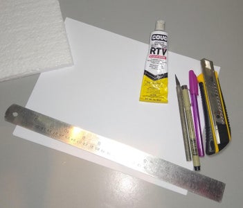

To make the mold:
  • Paper
  • Ruler
  • Marker and fine pencil
  • Expanded polystyrene (EPS) with 1 cm and 3 cm thick.
  • Cutters
  • Transparent silicone

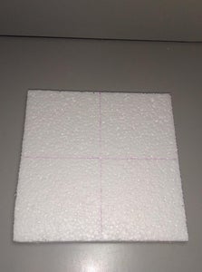

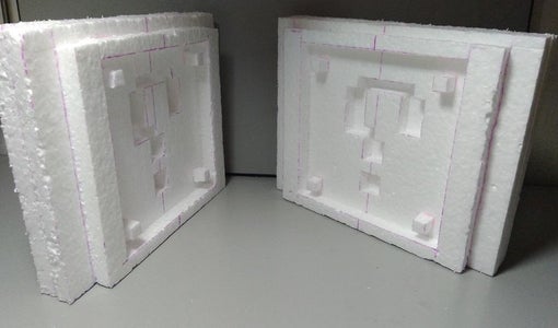

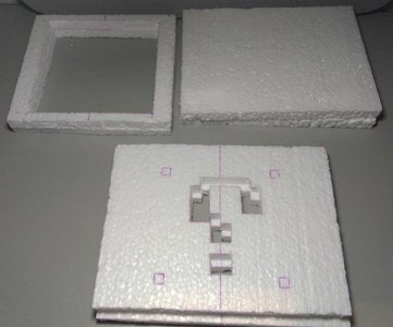

Step 2: Define Preliminary Cuts in Styrofoam
As shown in the picture, make:

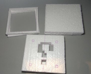

- Side A: Cut six (6) expanded polystyrene (EPS) rectangles 22 cm x 17 cm (with 1 cm thick EPS).
- Side B: Cut six (6) expanded polystyrene (EPS) rectangles 18 cm x 17 cm (with 1 cm thick EPS).
- Side C: Cut one (1) expanded polystyrene (EPS) square of 22 cm x 22 cm (I used 3 cm thick as this is the bottom part that will receive all the weight).
Step 3: Cutting Styrofoam
Having all the squares cut from the previous step:
- Take one (1) of the rectangles from Side A and one from Side B, and center the question mark design from Step 1, joining it at the bottom, leaving 1 cm extra above the rectangles. Mark the question mark and the squares on the inside corners (the marked squares will not be cut, it is for later gluing 1 cm cube pieces on them).
- Cut the question mark with a cutter, carefully.
- Take one (1) of the other rectangles from Side A and one from Side B and cut two frames.
  • From the rectangle on Side B, cut a 16 cm x 16 cm outer frame, 14 cm x 14 cm inner frame, i.e. a 16 cm x 16 cm frame, with a thickness of 1 cm.
  • From the rectangle on Side A, cut a rectangular frame of 18 cm x 16 cm, with a thickness of the sides of 2 cm, and the thickness of the upper and lower frame of 1 cm, resulting in an internal frame of 14 cm x 14 cm.

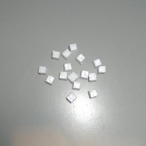

- With the remainder of these frames, make sixteen (16) squares of 1 cm cubed.
Tip: Use a wooden board over the cutting line to stabilize the cutter blade and make a sharp cut.
Step 4: Assemble the Cut Parts
Note: When making the mold, the face of the question mark should reverse, as if it were reflected in a mirror, so that when it is disassembled it will be right-side up.
Using the glue, assemble the respective layers of each side (A, B and C).
- Each Face A and B, duplicate to represent the lateral sides of the pot cube; these sides A and B, in turn, each have three (3) layers as done in the previous step.
- Glue Layer 3 to Layer 2, and Layer 2 to Layer 1.
- On Layer 2 of both Side A and Side B, glue the 4 cubes of 1 cm. In total there are four (4) layers 2: two (2) of Side A and two (2) of Side B, and each side requires 4 cubes of 1 cm, therefore they are the sixteen (16) cubes of 1 cm cut in the previous step.

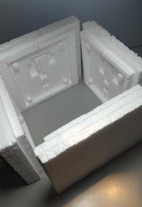

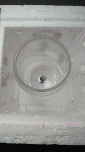

Step 5: Assemble the Mold

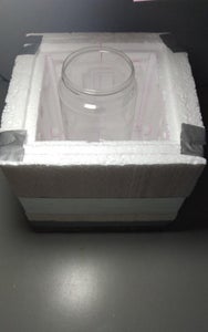

- Using duct tape and regular tape, join Sides A, B and C to make a cube without a lid.
- Side C goes underneath sides A and B.

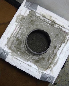

Step 6: Prepare the Mold

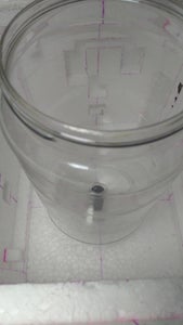

Glue one end of the tube (3.5 cm long and 1 cm wide) to the bottom of the cylindrical container with the silicone, and glue the other end to the center of the C side.
Tip: You can oil the walls of the mold to make it easier to disassemble the pot.

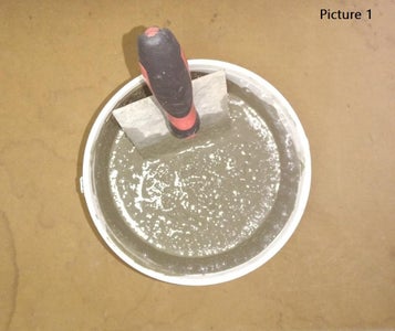

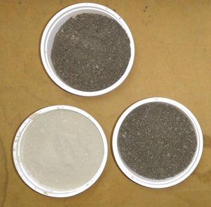

Step 7: Making Cement Mix

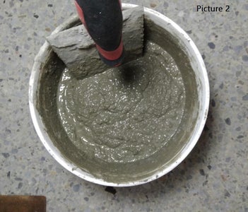

The ratio of sand to cement that I used is: 2 parts sand to 1 part cement, and about 1 part water (this is relative to the mixture because even the temperature of the environment influences, and what the mixture will be used for).
- Mix 2 parts sand (I used 4 kg of sand for this mold), with 1 part cement (2 kilos of cement) and about 1 part water (pour it in little by little, while mixing, and stop often to see the consistency).
- The consistency should be like creamy ice cream, or something like that.
In image 1, the mixture is too watery for this mold, as the water can run off.
In image 2, it is the consistency you are looking for this mold.

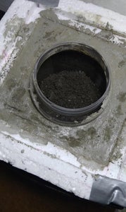

Step 8: Pour Cement Into the Mold
- Pour the mixture prepared in the previous step into the mold.
- Vibrate the mold carefully to eliminate the possibility of bubbles.
- Depending on the color of the result you want in the cement, I would recommend varying the sand used. The one I used is dark, gravel type.
Tip: Cover with a plastic bag to allow moisture to remain in the cement as this helps the cement to cure.

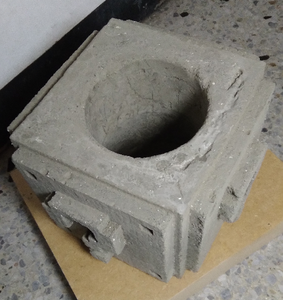

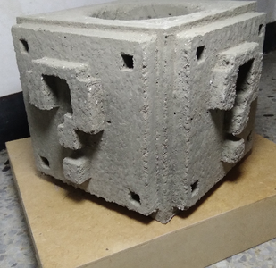

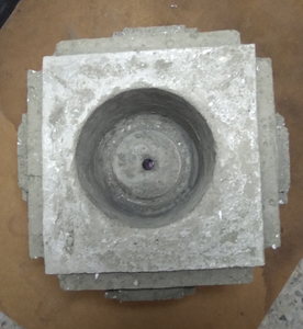

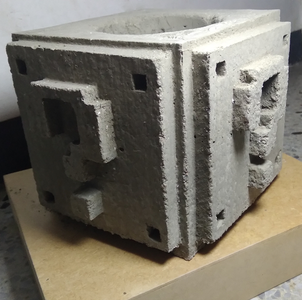

Step 9: Dismount

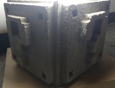

- In 24 hours the pot can be disassembled; 3 to 5 days it can be used, but keep in mind that the complete curing of the cement takes about 28 days.
- In this step, sandpaper can be used to remove any imperfections in the pot before painting. Wear gloves, goggles and a safety mask because this dust can cause respiratory problems.
Tip: Curing can be accelerated by constantly hydrating the cement pot. Some people after 24 hours and demolding, immerse the cement object in water and leave it for 1 week.

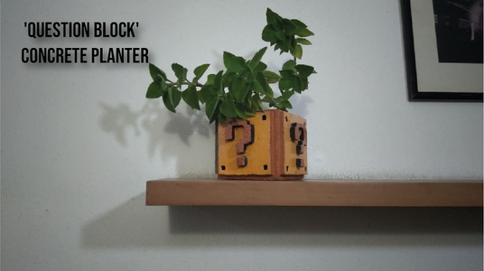

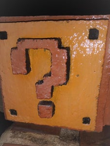

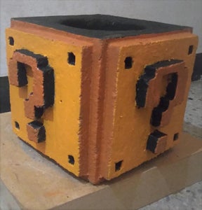

Step 10: Paint Flower Pot

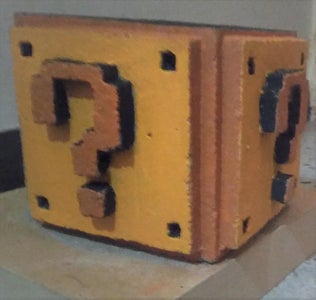

The pot has 3 colors. Black and two different shades of orange. For these two orange tones, you have to use these parts of paint approximately until you find the color:
For me it worked relatively well with these measurements:
- Orange 1 (#F8983C): Three parts yellow, one and one-half parts red.
- Orange 2 (#C84E27): Three and a half parts red, 2 parts yellow, a small pinch of black (ultramarine blue can be used instead).
After finding satisfactory shades of orange, you can use the painting guide.
After painting, use clear fixative to set the color (use a mask because the odor is strong, and preferably use the sealer in a ventilated area.)
