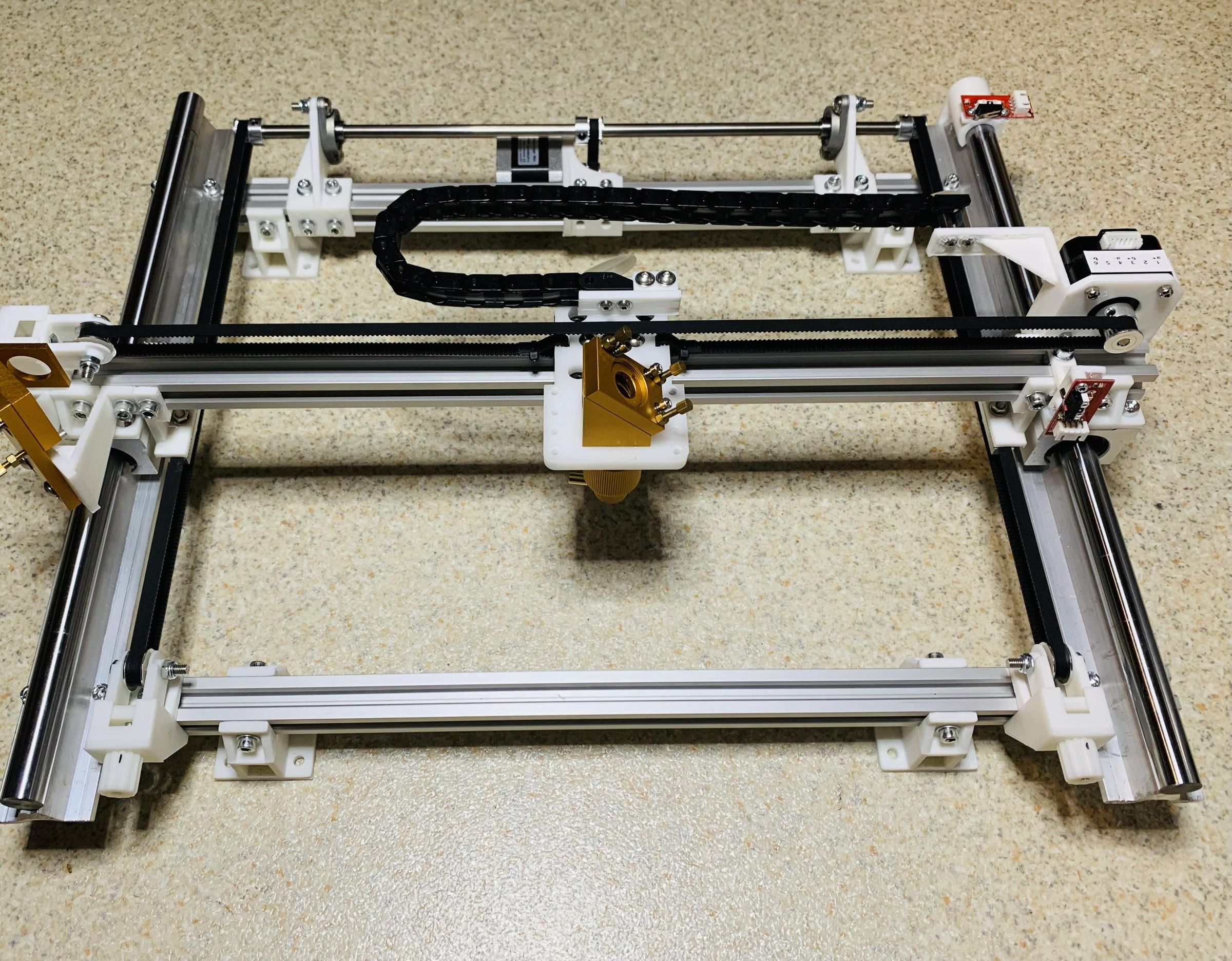

Step 1: Testing
First of all I tested the motors of the scanner and printer seperately. It turns out that they where unuseable (one of them was'nt a stepper at all), and therefore I have replaced them with two steppers I already have. If you are Lucky you wil find scanners and/or printers with suitable motors, mostly the older ones, so you don't have to spend time on changing them.
The greater part of the time in this project was spend on doing nothing but looking at the parts and thinking of how to put things together.
On the left of the first picture you see the printers ink cardridge carriage with the new motor installed, on the right the aluminum tubing. They lie on the scanner interior. These things has to be put together.
On the second photo I have the aluminum bolted down and on the third photo the ink carriage is bolted on the aluminum tubing.
In this stage you can test if the movements are working fine. The ink carriage rail works ok with the motor replacement but the scanner steppermotor does not due to the fact that there are geares between the motor and the drivebelt.
Step 2: Installing the Donor Motor
Pic1 the donor motor is waiting for replacement
pic2 the black square has to come out
pic3 does it fit... after some adjustments... Yes!
pic4 Bolt the new motor down with the spindle on the right height and the spindles axis on the same linear line as the old spindle.
The Original timing belt was'nt usable because of different tooth spacing so I installed one I had on the shelf. I had to make a length adjustment of course.
The procedure for replacement of the ink carriage motor (I forgot to make pictures) was the same with differences of course but the photos of the other one give you an idea of how and what.
Step 3: And Finaly, the Laser.
I could not find a good way to bolt the laser down on the ink carriage so I hot glued first a bit of aluminum sheet to it to make a flat surface and on that I hot glued the laser driver housing and the laser it self. Nice stuff, hot glue. It does the job and is very quick.
Here you can also see the hole I cut in the bottom of the scanner. Its important that the hole is not too big, otherwise the scanner bed is'nt parallel with the table and the laser won't be in focus on some spots.
This concludes the mechanical construction.
