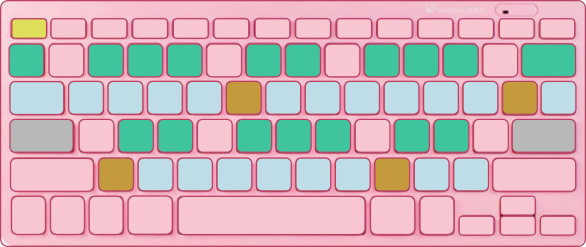

Step 3: Map Your Keyboard
Depending on your keyboard (and the keys that are not functional) and the software you use, choose which keys you will use to play. On my keyboard my first C note starts on the key "Z" and notes go up with keys to the right side (ex: C sharp is "S").. I use a second row of higher notes where "Q" is F and "2" is F sharp and so on..
Step 4: Customize the Keyboard
Here it's up to you. Because I use the keyboard mostly as a midi piano, I take care of making the keys that serve as notes (according to the map in the previous step) easily recognizable. In this example the original keys are quite flat so I glued keys from another keyboard on top of the keys I use as midi notes.
I have also kept black keys for sharps and spray painted keys for other notes. For visual comfort, I have C in green, E in golden color and the rest in beige.
Step 5: Other Example 1
Here I removed unused keys (with fingers or something hard and flat) to have a clearer space for sharp notes and spray painted two rows of notes (covering 3 octaves) in white for a piano look.
Step 6: Other Example 2
Here I have first spray painted all keys in white, then removed unused keys near the sharps. Then put a final touch with markers: notes are in blue with a black borders for C and sharps are in red. Note that the numpad on the right side can be used as a midi drumpad..
