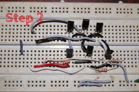

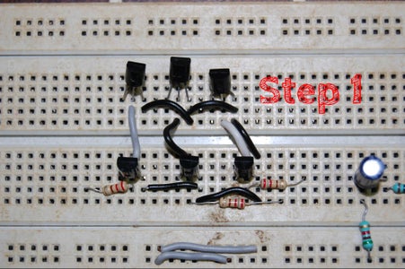

Step 2: Make the Transistor Circuit...
Transistors amplify the current from the Arduino for the LED strip. I have used 2N2222 Transistors as they can handle upto 600mA. That's only good enough to run a 1m strip bright.
Hence for 2m, we need six transistors (3 for each strip - red, green and blue LEDs). See the above Fritzing diagram and my circuit to make the transistor circuit on a breadboard.

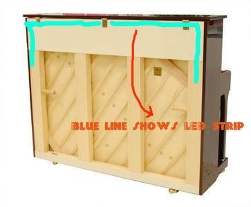

Using Double tape and normal sticky tape, stick the 2 RGB led strips to the back of the piano, as shown in the pictures above. Don't worry, the tape won't damage the wood of the piano, and can be easily taken of later. However, do not put too much tape either. The wire connecters for each Strip should accessible from the top of the piano...

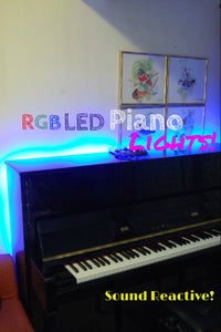

Now turn on your power supply, and you RGB LED Strip should light up wonderfully behind your piano! Playing anything will change the colour of the lights, depending on how loud you play.
This setup works great for parties, discos, clubs, and in my case, Christmas!!! Of course, you don't need a piano - you can mount these sound reactive LED strips anywhere; your house, table, sofa, bedroom, or your Christmas Tree!!!
