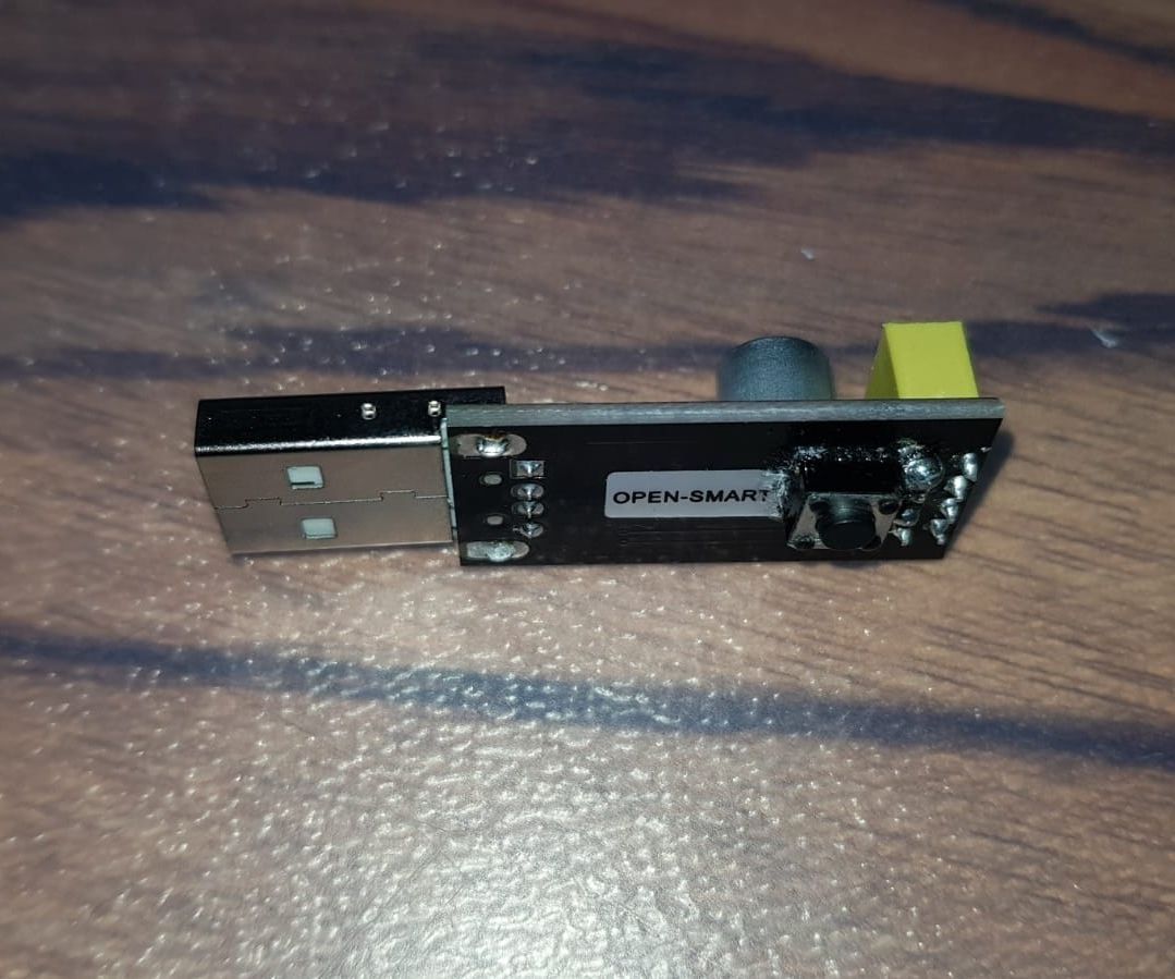

Step 7: Programming
Here you can download the source code for both languages: https://github.com/programandy/RGB-WordClock
Step 8: Assembling
First, bring the front panel together with the case and use the 3d printed nuts to fix it.
The next and final step to screw the rear wall to case the with 8 countersunk screws.
Step 9: Testing
After connecting the clock with a power supply, the Wemos creates an WiFi Access Point. With this Access Point you can connect your mobile phone. After that you have to go to 192.168.4.1 in a webbroswer (this should be the same as in the picture). After connecting with wemos you can configure your wifi and clik save. Now the Wemos is rebooting and hopefully connect himself with your Wifi and start to working.
