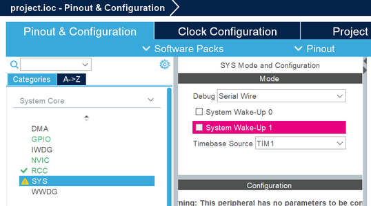

  1. Go to System Core>SYS. Under MODE>Timebase Source> TIM1.

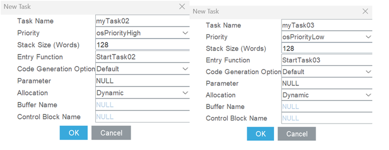

  3. Under Configuration>Tasks and Queues> Create Tasks and assign priorities to each task.
  4. Here we have 3 tasks: one is the default task, Task02 and Task 03.
  5. Add 2 tasks and assign high priority to task02(IR Sensor) and lower priority to Task03(DHT Sensor).

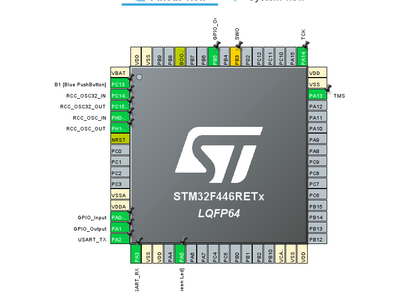

Step 6: Go to Pinout View
  1. Select GPIO_INPUT for Pin PA0(Connected to IR Sensor).
  2. GPIO_INPUT for Pin PA1(DHT Sensor).
  3. GPIO_OUTPUT for Pin PB5(Connected to LED).
