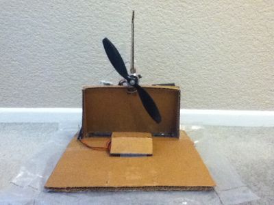

Step 3: Assemble the Hardware

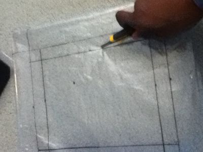

1. Using a flat closed plastic bag, mark the bag with the dimensions listed. The actual bag should be about 16in x 14in.
2. Cut 3 inches into the actual bag's length and width. (leave an extra inch to provide a surface for the cardboard to rest)
Also, to clarify, cut completely through the bag.

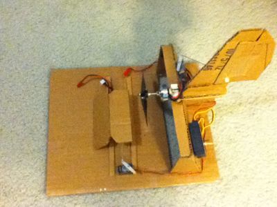

3.Cut a piece of cardboard 12in x 10in.
4. Cut a 2in x 8in hole in the cardboard panel (as seen in the 5th picture from the top.
5. Create an inlet to force air into the plastic bag(skirt). The inlet should be at least 8 in long and 4 in wide for the propeller.
6.Attach the motor to a wooden rod and secure it to the craft thus allowing swap-ablilty to the motor
7.Create a vertical stabilizer with a rudder and add any supporting pieces if necessary.
8.Glue down the vertical stablizer
9. Attach the rudder to the servo using connecting rods or cables.
10. Tape down all other electronics to the back of the inlet to ensure swap-ablilty of electronics
11. Glue the plastic bag(skirt) to the cardboard panel
12. Make a cover over the battery (as seen in the last picture) so that it stays put.
*Few dimensions are given for these steps, because there are few critical dimensions necessary for the hovercraft to function. Experiment with the dimensions to see which works best for you.
