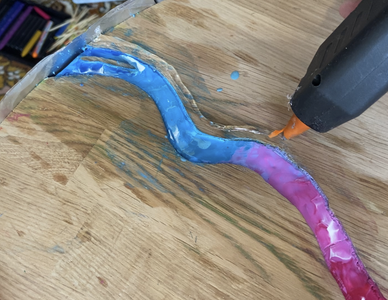

When the crayons melting, they are mixing their colors. You can mixed them with toothpick.
Step 8:
When the wax cooled up, i scraped away the overflow wax, leveled the surface. I cleaned and covered the corners with metallic adhesive tape. So my epoxy will not run away. I also made a borders with hot gun.
