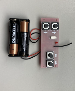

Connect each motor to its own separate receiver using the wires included in the transmitter and receiver kit, and connect the receiver's battery wire with a battery that has a socket that fits the receiver's battery wire (Again I used 3.7-volt batteries because I had already cut off the plug) to each receiver's battery and put two AA batteries in each transmitter's battery case. Look at the above picture of the receiver board to see what I mean by that. Make sure that when you turn on the receiver with its switch, it flashes, and it stops flashing when you press a button on the transmitter. Any button on the transmitter should make the motor turn. Also, only one motor is needed, as the other one is for the rudder which is optional. You won't be able to turn it as well, but you still can move the propeller motor in a way to turn it without a rudder.

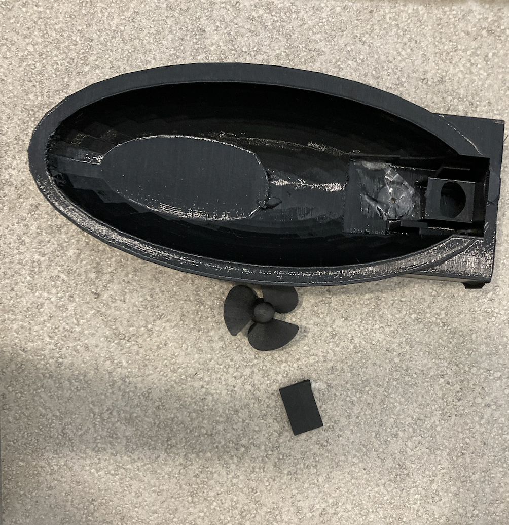

Step 2: 3D Print Parts for Boat

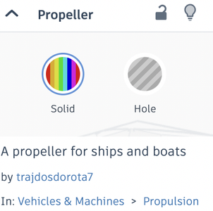

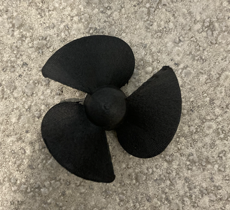

I have modeled most of my own pieces like the boat body and rudder using Tinkercad. I also modified a propeller found on the Tinkercad shape selection to fit my motor.
Print the body of the boat in ABS if possible and with 25% infill, and the rest of the models can be printed like normal. If you don't have ABS, you can also use PETG, and if not possible, you can try to use PLA.

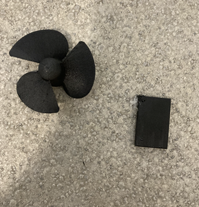

These models can be found in STL format in the links below on Cults (Because I can't figure out how to make a model public.;)
Boat Models: (Click here)
The hole in the back of the boat body is for the propeller. The hole in the bottom is for the rudder motor. If you are not using the rudder, cover the hole on the bottom of the boat with tape or resin.

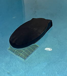

Put all the electronics in ziplock bags to make sure they do not break from water damage. Stick the propeller motor's rotor shaft through the plastic, and put its rotor through the boat's back hole, and then connect the propeller by sticking the motor's rotor shaft into the hole and putting some hot glue into the hole of the propeller, and then sticking the rotor shaft in. If you are using the rudder motor, Put one of the motors through the hole in the back, and use the same method of waterproofing for the rudder motor, which, if you use it, should go into the hole at the bottom of the boat, before attaching the rudder. Put tape and saran wrap to waterproof the small boat hole for the motor areas as best as you can. Use a soldering iron to make sure your motor fits perfectly. After all the electronics are in the boat, put the boat's roof over the boat, and attach it using tape as you will have to take the roof off again. Now you are done and you can put it into water and test it out!
Step 4: Have Fun
You can use this instructable to make a boat that floats on water and can carry things in the hull, or make a fast remote control motorboat that zooms across it. Either way, if you get it to work, you should have fun both in testing and in building. HAVE FUN!
