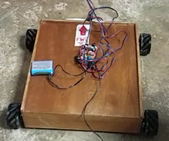

Step 6: RC Car (old Times Laugh...)
Just for the laugh and memory - the first RC Car I made - few years ago...
