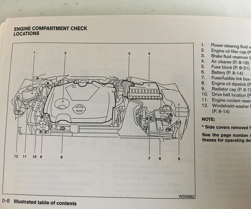

Step 3: Locating and Changing the Air Filter
1. Locate the hosing by looking for the “Engine compartment check locations” in your owner’s manual. (as you can see the air cleaner was label with number 4 in the picture)
2. Undone the clamps to open the Air cleaner.
3. Remove the old filter and replace it with the new filter
4. Close the housing.
