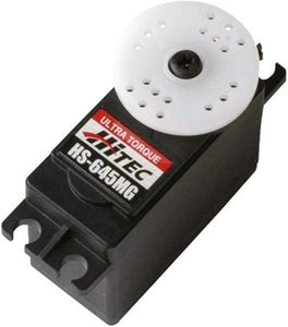

  1. Four servo motors for the hinges
  2. https://www.amazon.com/Hitec-32645S-HS-645MG-Torque-Metal/dp/B003T6RSVQ/ref=sr_1_1?crid=2YYLXZSVLWOV2&dib=eyJ2IjoiMSJ9.tat9Yj1iSkYVCCP7fkJGHtulRFM7i5ljlklhGrHWhT3wBm1ERIm3qV9SZGJMdMsTFxiD1GPwtZSSP1Q1Z92x6iTDAJBUlg52-9fPsMaKg4T3nI7O-S3hc4L-EipOQKa3lZfB52AdUcYco6UZVgRW2N1ej-VImqftKRKQ48_Ut9pBCQ2tPiV7DkadctXOVSmDbBQZtUCeVDLa0LYnjWGwa3ezh5R3GctvF3JXSCte7WaZd5ZzjDaEX0VN8zpQXzXMFK9pGHcaE8GzNEa_30_RznvOziZc-9rKU3jZ-gHTUDU.nJ6c_T4VNgpkVUA7DLZ3BNac1fDISp0xlJRL6ihl8Zc&dib_tag=se&keywords=HS-645MG%2BHigh%2BTorque%2BMetal%2BGear%2BPremium%2BSport%2BServo&qid=1711665853&sprefix=hs-645mg%2Bhigh%2Btorque%2Bmetal%2Bgear%2Bpremium%2Bsport%2Bservo%2Caps%2C103&sr=8-1&th=1
