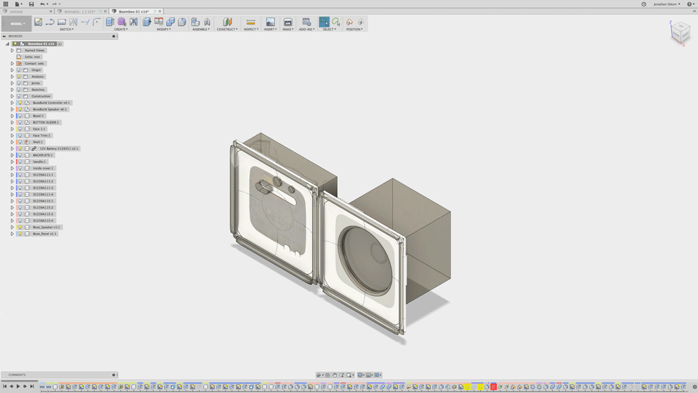

Step 3: 3D Modeling
I did the whole thing in Fusion 360 (just like everything else I design and make). I'll be doing a live webinar on modeling and rendering this project if you want to learn more. Check our Facebook page for updates!

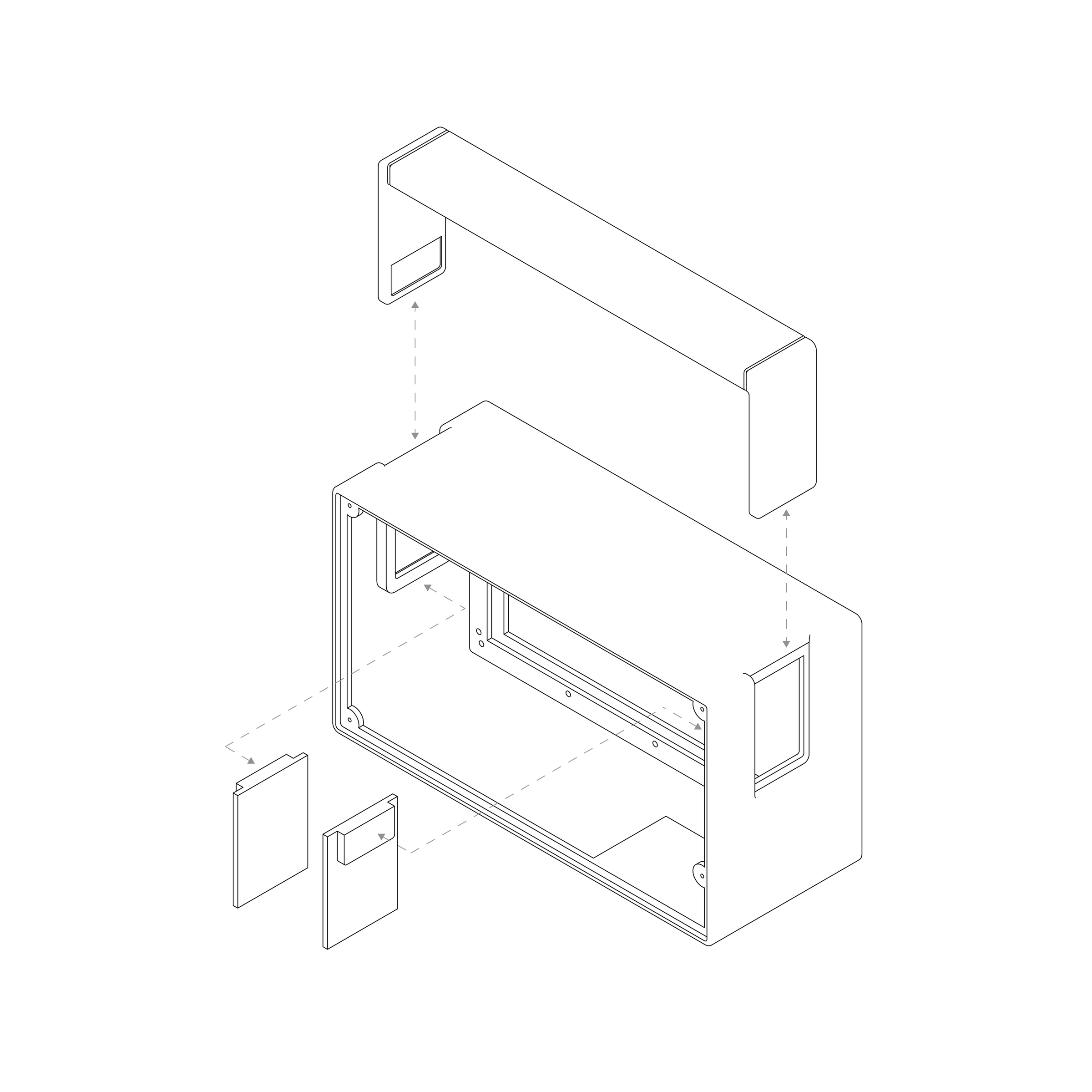

  1. .F3D Files: These are Fusion 360 archive files. To use them, click upload in the Data Panel in Fusion and they will open as a native file.
  2. .STL Files: These are ready-to-print exported parts. You'll need to print the "inside cover" part twice- these are the caps that keep the handle connected to the shell.
  3. .DXF Files: These are the 2D vector files for the front and back covers. You can use these to laser cut these parts or cut them by hand if you want, but I've also included STLs of these parts if all you've got is a 3D printer.

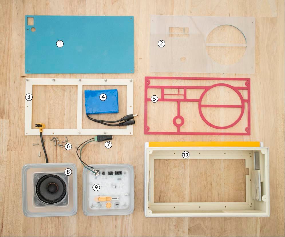

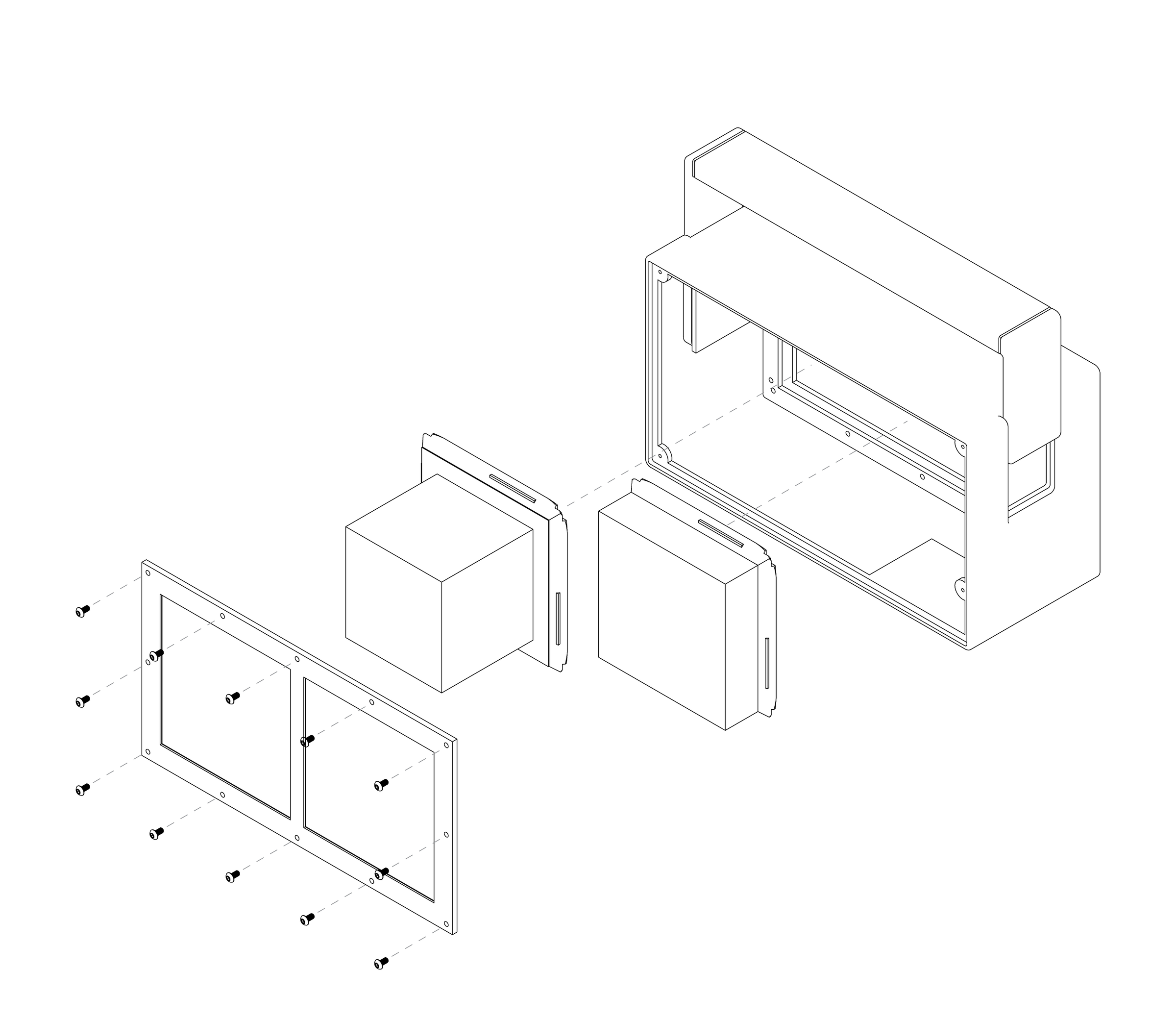

Step 10: Assemble
  1. Back Plate
  2. Front Plate Lower
  3. Bezel
  4. Battery
  5. Front Plate Upper
  6. M3 X 10mm Screws
  7. Power Cable
  8. BOSEbuild Speaker
  9. BOSEbuild Speaker Controller
  10. Chassis + Handle
The shell is designed with nut pockets on the front, but the holes are small enough that you can just thread the screws into the plastic. I used a 3mm tap to tap the holes to make sure the screws had good purchase.
The speaker and controller go in side-by-side with the speaker on the right. There's a recess in the shell that keeps the parts in place. The bezel has two holes in it that let the backs of the speaker and controller poke out. The cable has to be plugged into the front of the controller before the bezel is screwed on.

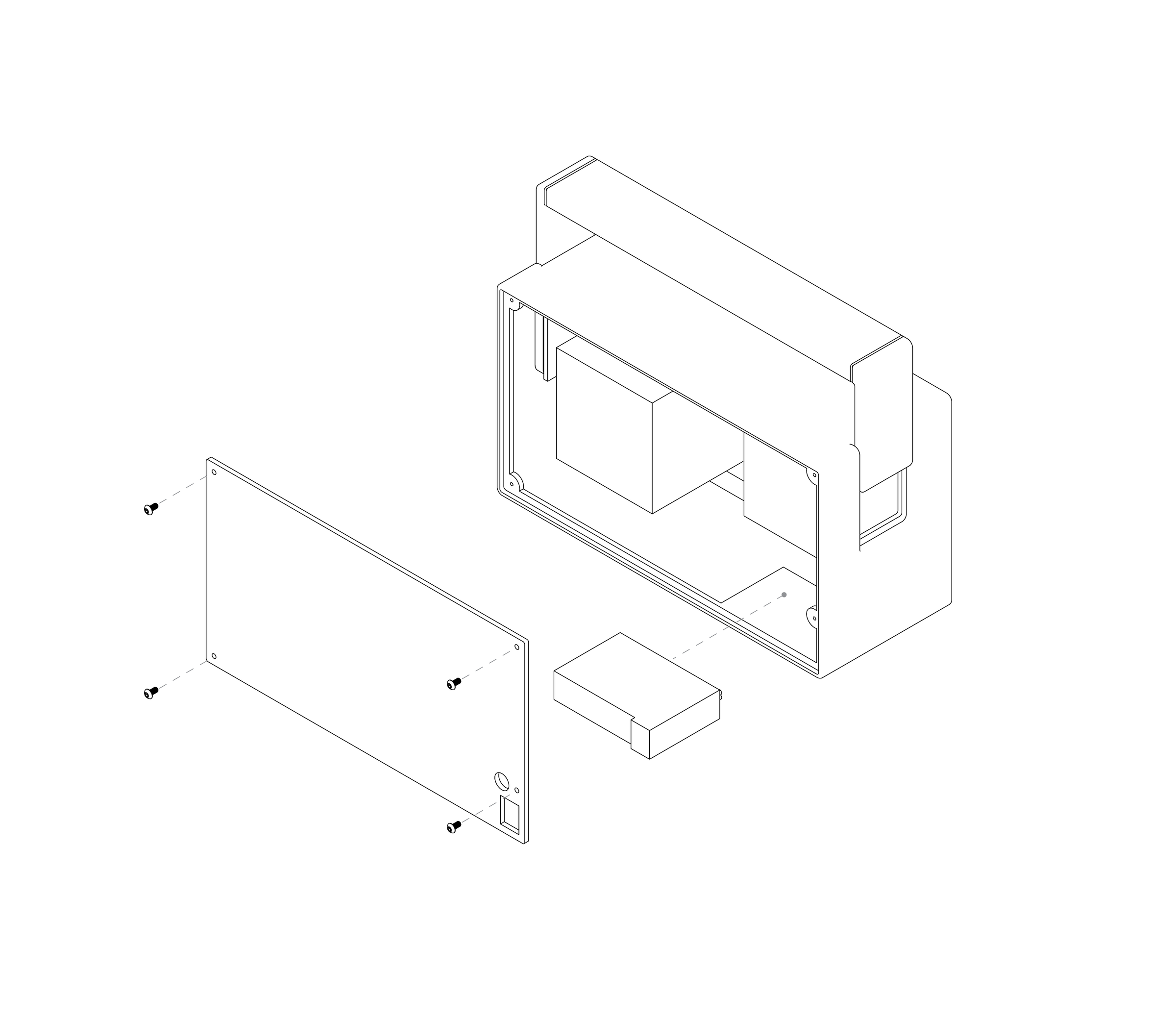

The cable is the only part that's soldered. The male terminal has screw terminals on it and the female elbow terminal has solder terminals. I left off the plastic cover for the female terminal and cut off the longest part of the + solder terminal so it would fit behind the front panel.
Next, I added the battery and the back panel. The battery has an input and and output built in, so I just plugged the output into the cable from the controller. The charging input goes into the hole in the back panel. I used a little hot glue to keep it in place, and I used double-sided tape to keep the battery in place. The battery has a switch that I made a hole in the panel for as well.

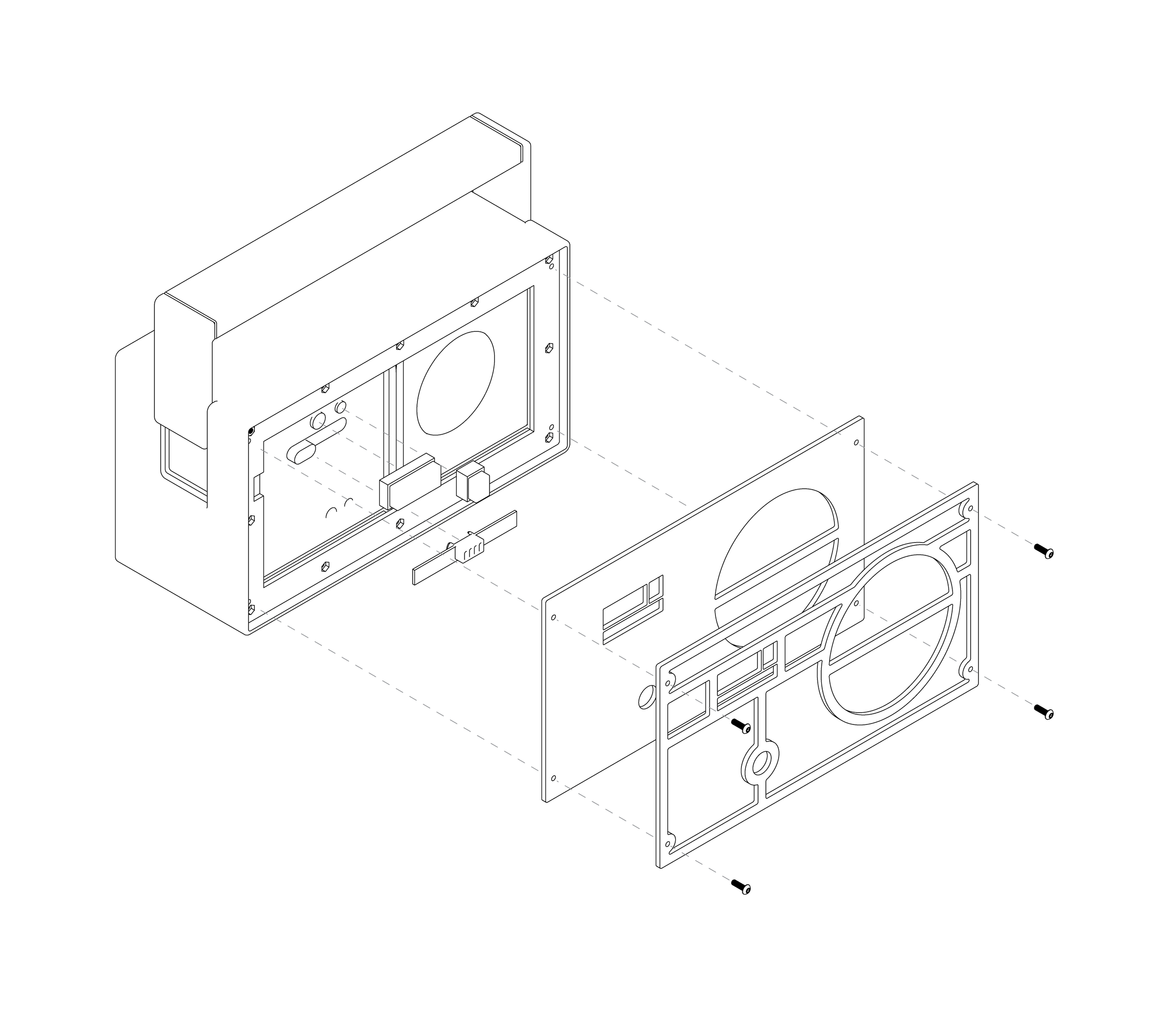

The front panel is pretty straightforward except for the buttons. The easiest way to do this is to press the slider onto the slider on the controller first- it will stay in place. The buttons should be inserted into the front cover and held in place while the covers are placed on the shell. They will be held in place by the buttons on the controller.

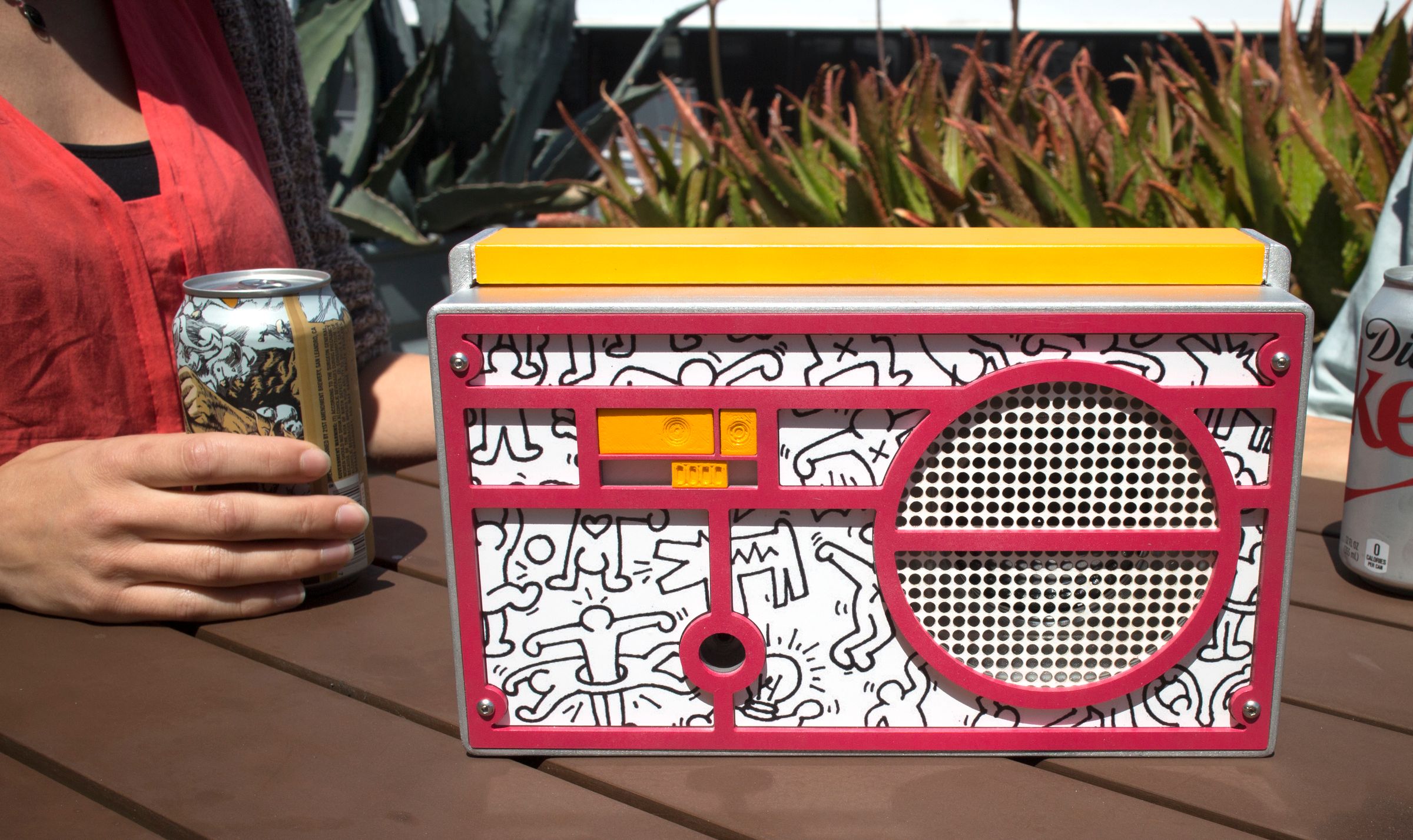

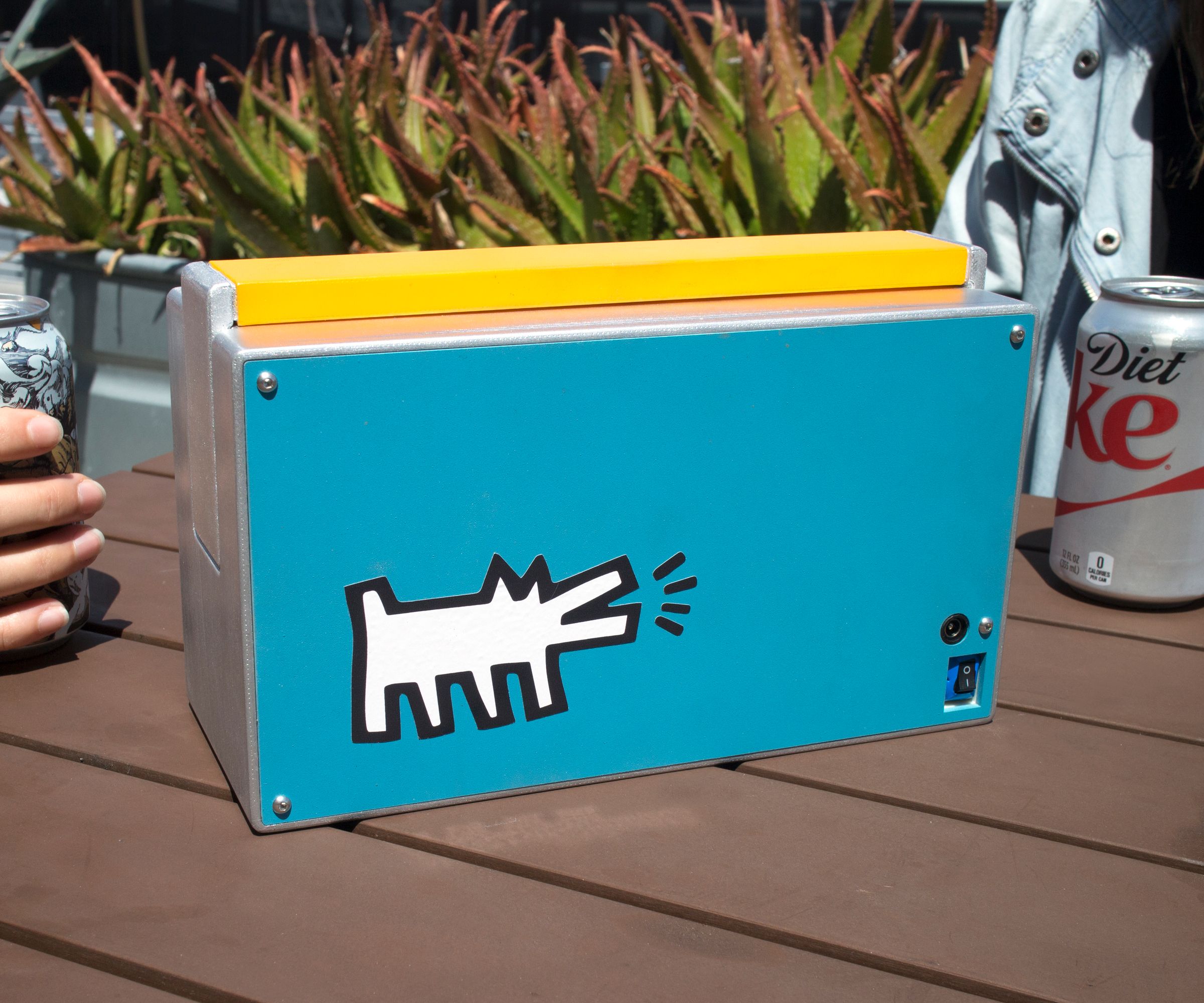

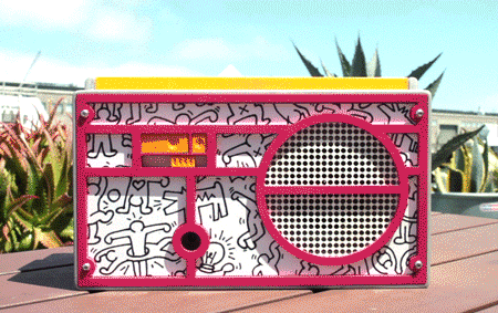

Step 11: Decorate and Rock Out
I made some vinyl stickers based on Keith Haring paintings to pull the design together.
Overall it sounds great and people love the look. The hole in the front lets you plug in an AUX cable in case you want to listen to your Walkman.
