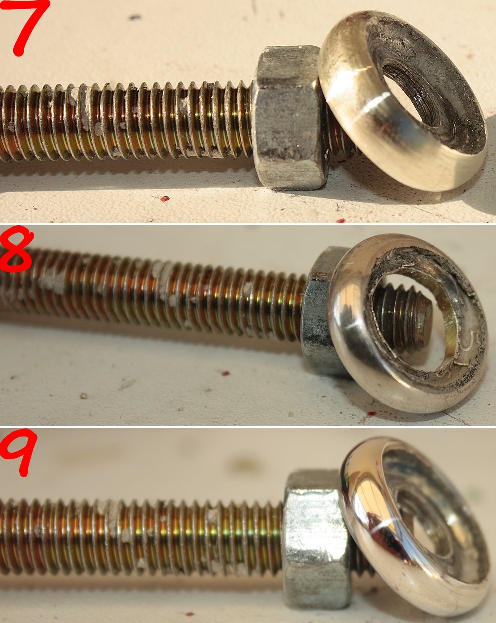

-Drill the coin and Insert the screw with tighten the nut (see picture).
-With a hammer, we must train the ring.

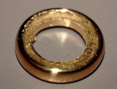

-Once the desired size, start sanding the outside of the ring.

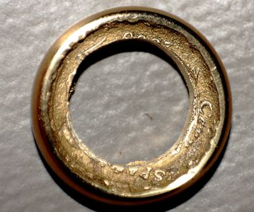

-There is the inside of the ring to drill, then sanding.

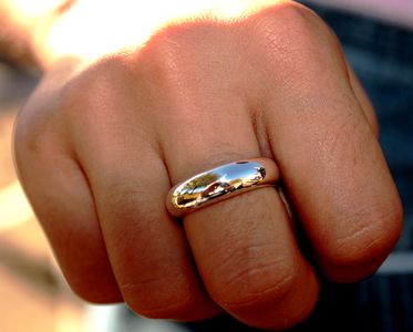

-Last step, polishing
