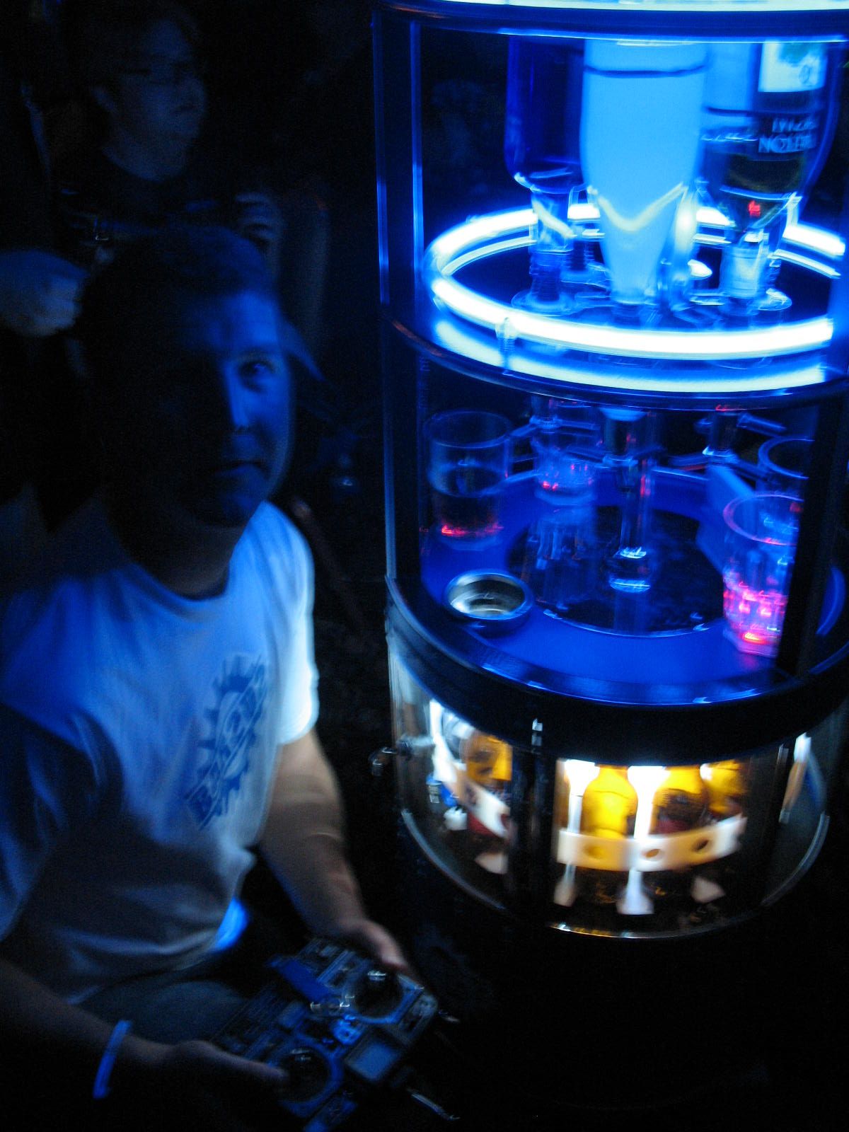

Introduction: Robotic Drink Mixer
It's time to head back to college and that means lots of fun, parties, and EPIC TAILGATING!  (Go Razorbacks!)
BUILD A ROBOTIC DRINK MIXER!
This is a portable system that can mix over 5,000 drinks on demand from a laptop computer.  Build it and they will come!
Here is what the Robotic Drink Mixer is capable of:
Some of you may have seen my other instructable last year, BaR2D2, the mobile bar.  This is the long awaited drink mixer upgrade!  If you want to see the robot this can attach to, go here:
https://www.instructables.com/id/Build-A-Mobile-Bar-BaR2D2/
This system was built to replace the manual liquor carousel.  It has been an incredible upgrade and we have had a blast with it!
You can friend BaR2D2 on facebook:   bartwo dtwo

You can see the full BaR2D2 robot in this video taken from a late night party in Atlanta a couple weekends back at Dragon*con.  It's always a blast to take it out!
