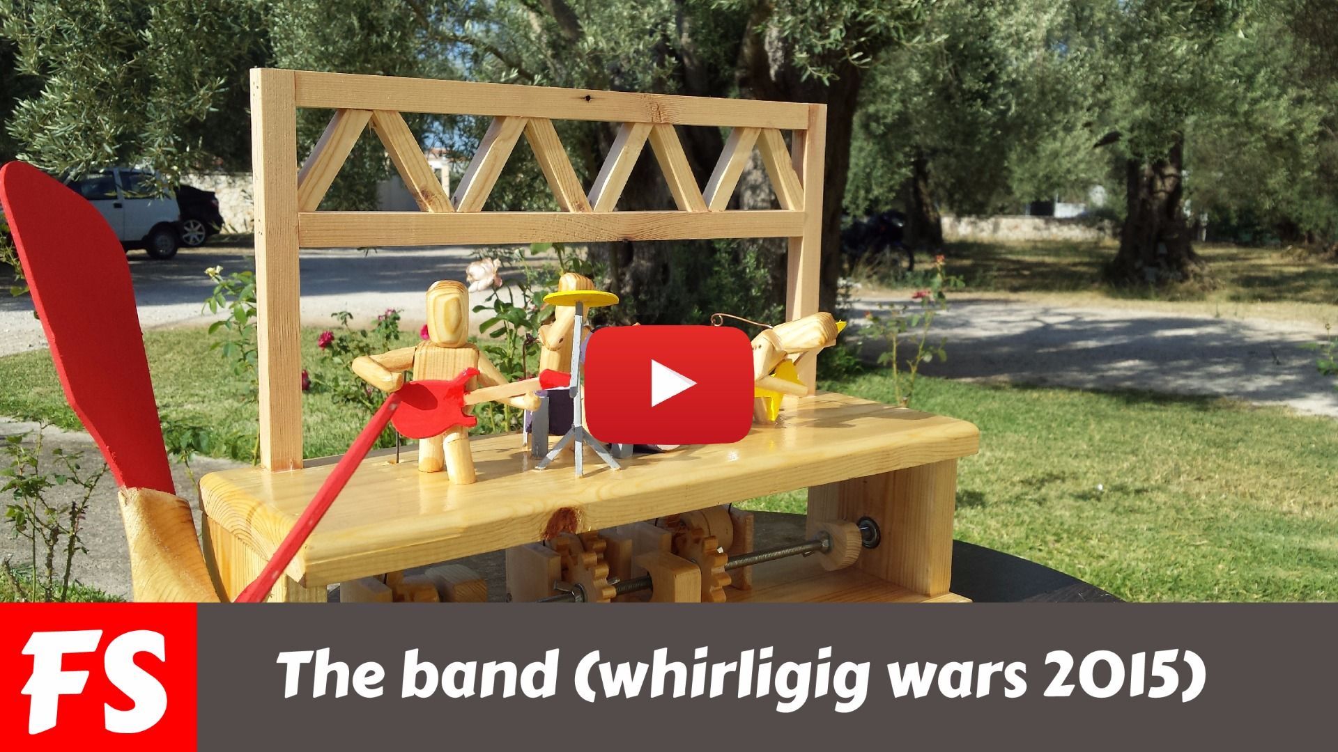

Step 1: Making the Rotor and Blades
On the two first pictures you can see the rough plans I have made for the rotor and blades, I have used pine and 4mm plywood for the blades
I cut everything on the band saw sanded all the parts and glued all together as shown on the images above.
After the glue to set I used a rasp to form the wooden block and drilled a 8mm hole right in the center of it.
Step 2: Making the Base
For the base I have used two pieces 12 x 10cm (WxH) and a 45 x 15cm and glued them as shown on the pics. Before I glue them together I drilled two holes on the small pieces 3cm from the bottom. Those holes will accomodate the bearings and the shaft for the gears.
Step 3: The Stage
The stage is also a 45 x 15cm piece of wood. I also used some 1.7 x 1.5cm stripes of wood to make the stage towers for the lights...
Step 4: The Instruments
The first instrument I did was the drumset. I cut a cylinder using my 4.5cm hole saw and attached two small pieces of wood to form the bass drum legs. For the tom toms I used a 2.0cm and a 2.5cm hole saw. Attached them on the bass drum with some glue and my nail gun. A 2.5cm hole saw was used for the floor tom.
I designed the guitars on a thin piece of wood and cut them on my band saw.
Some thin pieces of wood were used for the cymbal stand.
(I am sorry I can not provide many details for the exact dimensions but really everything I did on this project was not planned.)
Step 5: The Instrument Players
Also here everything is made freehand. I used a 2.8 x 3.5cm piece of wood for the players body and then some dowels to form legs and arms. I wanted the arms of the players to ba able to move so I did not glue the soulders on the body, just used some 2.5 cm nails.

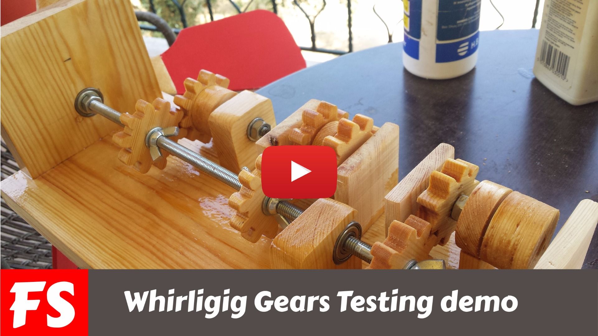

Step 6: The Gears
I have used a gear generator to design the gears,which I cut on the band saw. I have attached them on the metal threaded rod with some wing nuts.
Step 7: Using It
Once the stage was attached on the base everything was ready for painting.
Now we let the wind do the rest!
