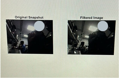

We can run the main code (code 4), ensure all your hardware components are connected to your PC/laptop, and then run the final code. This part involves bilateral filtering to enhance the image quality; a snapshot is captured when the gesture has been recognized. Once the snapshot has been captured, the image is then changed to a greyscale to make the filter process smoother, and then the original snapshot and filter image are displayed.
