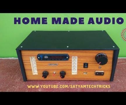

This is a high quality audio player made to fit in a loading auto. Its sound quality is really amazing. In this player I made a very special touch switch using ne555 ic and an LDR that works amazingly. but in this instructable I could not mention it. I will show about it in my next instructable or in some of my next YouTube video on my channel "Satyam TechTricks"
