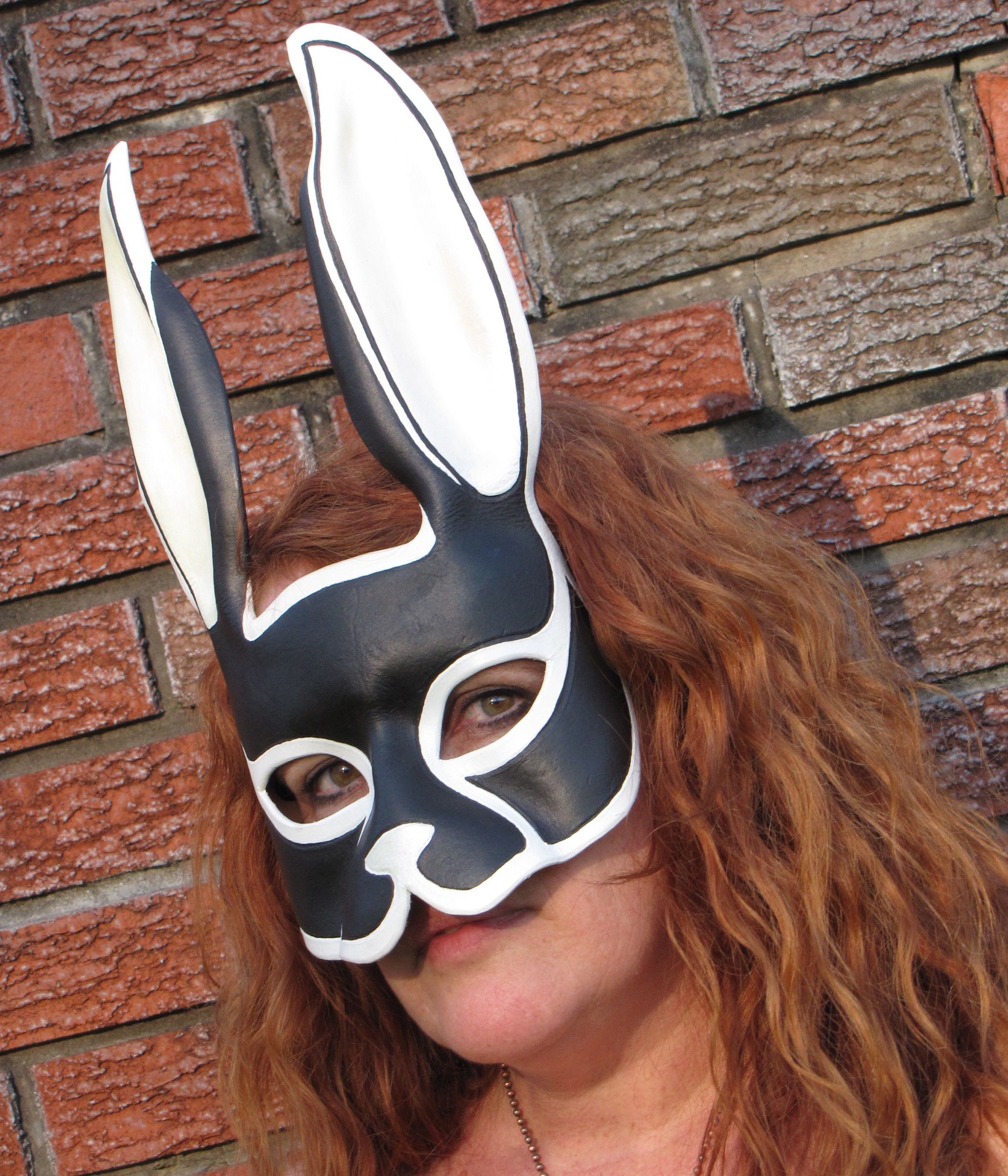

Now wear your leather mask proudly! You did it!! I hope my mask instructable gave you a good start in the world of leather mask art!
I'm adding a few photos of some of my other masks to inspire you. I'm including some of the Splicer mask that I used for the sculpting portion of this tutorial.
Once again, please be inspired, but don't please don't copy the work of other artists!
