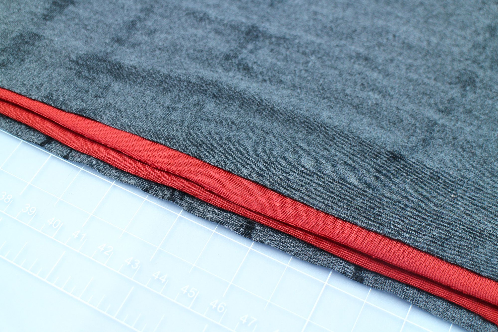

Fold over the edge of your fabric and pin to create a hem. On knits you almost always want to create only a single fold hem, not a double fold, unless you want to intentionally create a hem with more structure, like on a neckline.
Set your machine to the straight stitch setting and a stitch length of about 2-3. Sew as you would normally an even distance away from the folded edge.
The double needle should create two lines of stitching on top of the fabric, and a zigzag between them on the bottom.
If the zigzag is pulling the two stitches together and creating a pucker between them on top and a tunnel underneath, tighten the thread tension on top and loosen it on the bobbin until the stitching lays flat.
