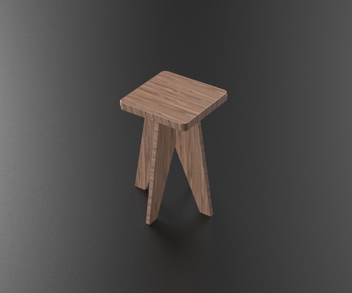

The purpose of this instructable is to show how to work and use with laser cutter machines, especially for beginners (like me). The side table in the picture is a scaled model to show this process.

Design your own side table
In the attachment, you can find my 3D file of the side table. You can adjust in size or shape or create your own design. Tip: start with sketching on paper, before you go 3D.
