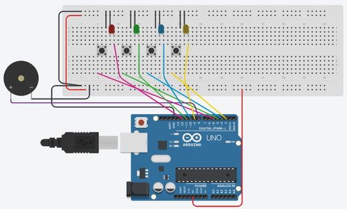

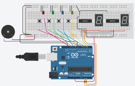

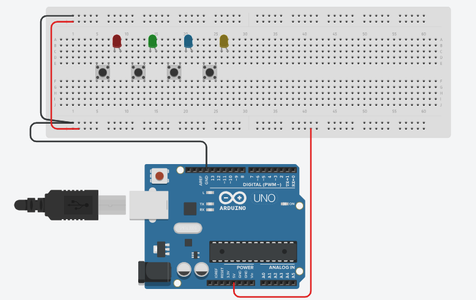

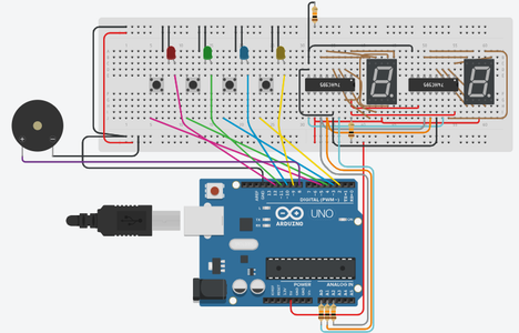

Step 1: Wiring and Setup
For wiring help, look at the images above.
  • Connect power and ground from the Arduino to the power and ground rails on the breadboard. This will give easy access to all the parts on the breadboard.

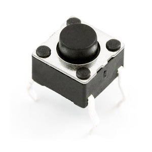

  • For this part, you will need to attach your pushbuttons in the middle of the breadboard along with the LEDs. The sequence should be pushbutton then LED. This must be repeated 4 times.
  • Once the previous step is completed, connect the LED's and pushbuttons to ground and their assigned pins.
Assigned pins (left to right):
  1. Terminal 1a to pin 5 (pb #1)
  2. LED anode to pin 12 (red)
  3. Terminal 1a to pin 4 (pb #2)
  4. LED anode to pin 11 (green)
  5. Terminal 1a to pin 3 (pb #3)
  6. LED anode to pin 10 (blue)
  7. Terminal 1a to pin 2 (pb #4)
  8. LED anode to pin 9 (yellow)

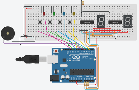

  • Next, take a buzzer (types listed above) and connect its negative leg to a ground rail and connect its power leg to pin # 8.

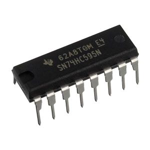

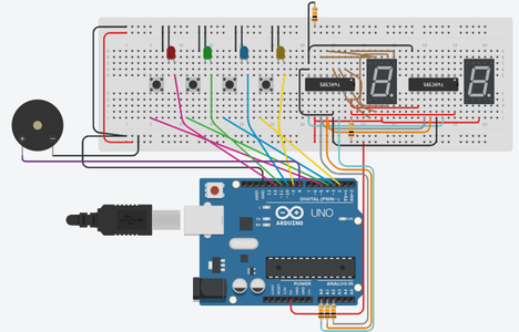

  • After that, take two shift registers and place them upside down in the middle of the breadboard with 7-segment displays in between.
Shift register guide for those who don't know how to work with one.
Shift Registers' connections (left to right):
  1. Connect pin #9 to the second SR pin 14.
  2. Connect pin #10 to a power rail and the common anode pins of the 7-segment displays.
  3. Connect pin #11 to Arduino pin A2 with a 10k Ohm resistor and to the second SR pin #11.
  4. Connect pin #12 to Arduino pin A1 with a 10k Ohm resistor and to the second SR pin #12.
  5. Connect pin #13 to SR pin # 8 and to the second SR pin #13.
  6. Connect pin #8 to a ground rail with a 10k Ohm resistor and to the SR pin #8.
  7. Connect pin #14 to Arduino pin A0 with a 10k Ohm resistor.
  8. Connect pin #16 to power with a 10k Ohm resistor and to second SR pins #9 & #16

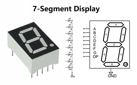

7-Segment Display connections (Alphabetically):
  1. Pin A to pin 15 on SR #1
  2. Pin B to pin 1 on SR #1
  3. Pin C to pin 2 on SR #1
  4. Pin D to pin 3 on SR #1
  5. Pin E to pin 4 on SR #1
  6. Pin F to pin 5 on SR #1
  7. Pin G to pin 6 on SR #1
Repeat the same 7-segment display connections for the second shift register.

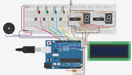

  • Finally, take a 1602 LCD (I2C) and connect it to power and ground along with its other connections.
