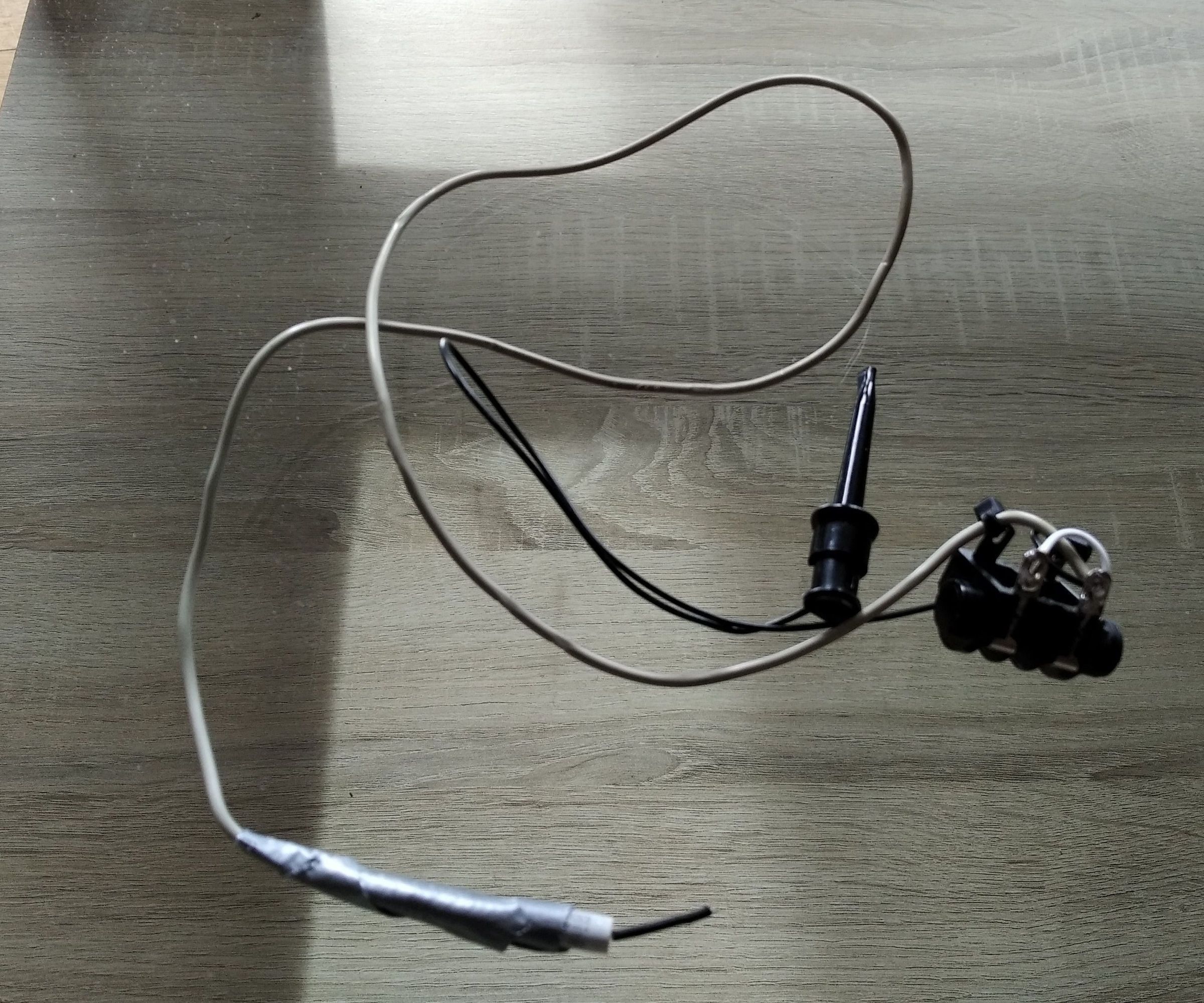

Step 1: Connecting the LED
Take the LED and spread the legs so they can go over the battery poles. Connect it to the battery so it lights up.
There are poles on battery and also on LED, so it lights up only in one direction (but there are only two possibilities, so it is quicker to just try than to orient and then connect).
There is a small possibility that one of the pins of LED would bridge battery poles and cause short circuit, but it never happened to me - just check for this.

Step 3: "Clipping" the Light
Put a binder clip so it clips over the paper and so provides a tight contact between the battery and LED.
Use of binder clip here is the part which is the reason I made this instructable - because I played with LEDs and 3V cells a lot of times (for ordinary LED this is the quickest method to test if it works). When you grip it, the LED is bright, but when you let go, it turns off. And it is quite hard to persuade the LED to stay in contact. Sticky tape doesn't work and soldering on those cells is hard. On the other hand biunder clip not only works, but provides a quick assembly - disassembly.
On this step you have a functioning, quite sturdy LED light and you may even not proceed further - the "handles" provide a nice fixing point
