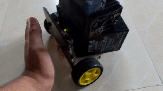

In this project, I will be building a simple car for my small brother. This car contains two infrared sensors at the back so you can control/steer the car by just placing your hand.
I have used only basic circuitry to make this project, no microcontroller or coding is needed. Let's start with the equipment needed.

Step 1: What It Does?
I can control and steer the car with my hand! As you can see from the video above, I have placed a lot of load over the car just for fun :)

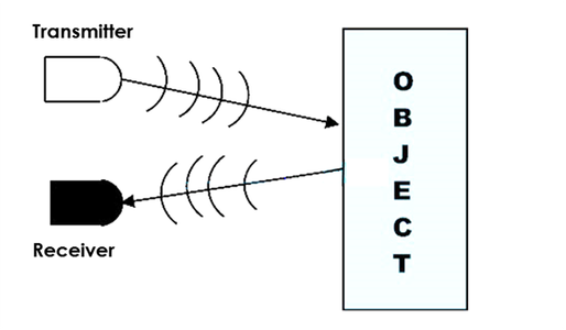

Step 2: Working Principle
The sensor contains two parts, sender and receiver. The IR led continuously sends an Infrared wave. Any obstacle that is not black reflects an IR wave and it can be detected by the IR receiver.
The IR receiver is basically an NPN transistor whose gate is light-sensitive. So if infra rays hit the base the transistor turns on (it is basically acting as a switch).
When the sensor detects an object it supplies base voltage to the PNP transistor. This transistor is connected to the motor. As the PNP transistor turns on, it turns the motor on.
