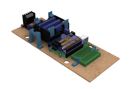

Step 2: Assemble Your Curcuit Board
To begin the construction of your robot's inner workings you must design a circuit board to attach all of your components. You can either 3D print this or laser cut it.
Once you have completed your circuit board you can begin screwing in your components using this wiring diagram as a basis.
It's important to remember when attaching your Aurdino and daughter board that you first screw in your Aurdino and then attach your daughter board on top of it
If you are securing your battery pack make sure you use flat-head screws to avoid obstructing the batteries. Keep in mind that the length of the screw can affect how your circuit board fits inside your robot.
