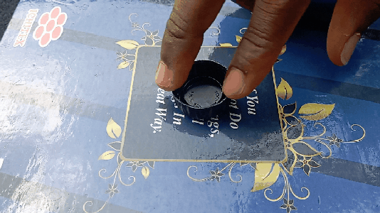

The most important thing to know is that the black bottle cap has a rounded bottom i.e not flat, so it allows the cap to wobble when disturbed unlike the bottle cap with flat bottom (the orange cap). The black bottle cap is for Coca-Cola and I found that most of their bottle caps have the same rounded bottom. The rounded bottom allows it to spin/roll much more easily.

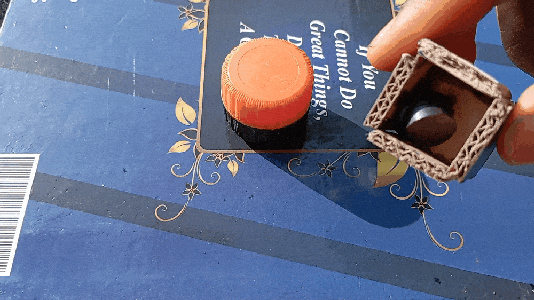

From the picture above, this toy is made up of two different parts; a spinning top made of the two bottle caps which spins when near the spinner cube and the spinner cube (that causes the spinning top to spin using a repelling magnetic field) that is enclosed in the cardboard cube.

Take the cap with the rounded bottom (the black one in this case) and apply glue generously inside it. We will now take the cylindrical magnet we earlier made from the three ring magnets and quickly place it into the centre of the bottle cap (so it balances well without leaning more to one side than the other) make sure it is pressed into the glue. Leave it to dry well, it will take some time due to the large amount of glue applied.
When dried, shake the cap to check if the magnets are properly secured by the glue.
Covering it up with the second bottle cap.
Take the other bottle cap with the flat bottom (the orange one in this case) and apply glue around its rim, apply glue to the rim of the first bottle cap as well and place the two bottle cap together so the rims touch each other round while completely enclosing the inner cylindrical magnet.

Take the two disc magnets and place them on top of each other with the opposite poles so that they attract each other.
Tilt it by about 45° and place it in the corner of the arrow head formed by the cardboard, before applying glue, move it close to the spinning top we earlier made, if it repels each other then that's the correct side, if it attracts, flip it over so that it repels when placed next to the spinning top. Now glue the magnets into the corner by applying glue to the edges of the magnet making contact with the cardboard.
Attach two more cardboard squares to the other two sides and glue them in place. The last cardboard square should be marked with an arrow pointing to the corner where the magnets are glued so we can easily know which side to push against the spinning top without having to do any guess work. Now glue this last piece on top of the box to make a complete cube and then we have completed making our spinner cube.

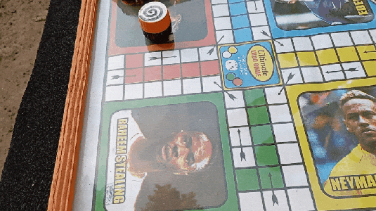

You can glue whatever you want on the spinning top so long it isn't too heavy or tall. For example, tiny plastic toy figures of superheroes, soldiers or even a dancing Barbie figure.
If you're like me and you don't have these toy figures already, we can cut a circular white foam and draw a spiral line on it with a marker and then glue it lightly to the spinning top (use just a tiny drop of glue, enough to hold it well enough to prevent it from falling off while spinning but also fairly easy to remove in case you want to use something else).
Trying it on different surfaces, it is obvious that it'll spin faster on smoother surfaces like glass.
