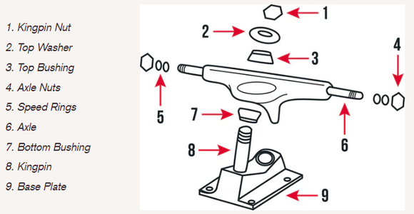

I used a mountain skateboard instead of a regular skateboard because it has larger pneumatic tires and a wider deck for more stability and control at higher speeds. It is important to replace the bushings for stiffer ones to provide support for the additional weight of the sail.
There are two bushings on each truck, four total on a skateboard (click on the diagram above). To replace the bushings, unscrew the bolts holding the skateboard trucks. Disassemble the trucks by unscrewing the kingpin nut and remove the axle with the wheels along with the bottom bushings. Replace the old bushings with the newer, stiffer bushings. Then tighten the kingpin nut, and reattached only the back truck.
Diagram from: https://www.lucidgrip.com/blogs/news/skateboard-trucks-and-parts
