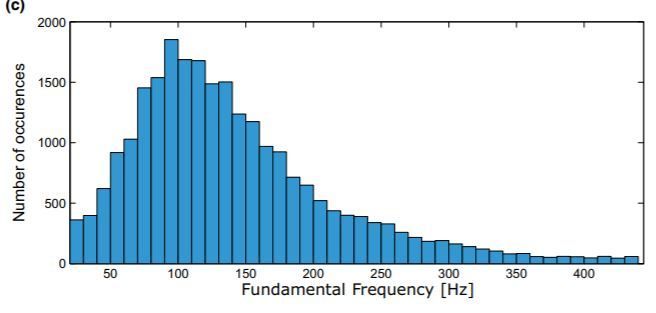

However, the Journal of Sleep Research has published a paper called "How to measure snoring? A comparison of the microphone, cannula and piezoelectric sensor" in 2015 (ref. J Sleep Res. (2016) 25, 158–168) that indicates that snoring sounds of people from Iceland have a fundamental frequency range mainly in the 70 - 160 Hz range.
This was encouraging: I am not the only one who addresses this problem...

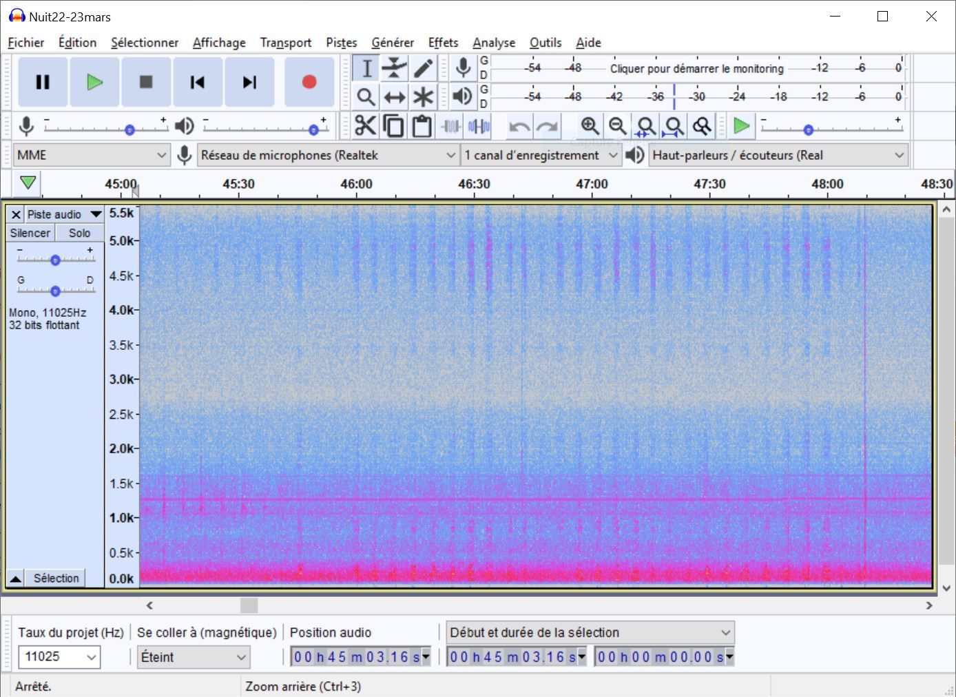

Audacity is a free software which can record and analyze sounds. I installed it on a laptop, that would stand aside form my bed during the night. I set it up to record all sounds in the bedroom and save that in a wav format.

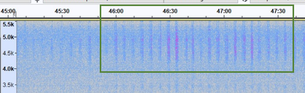

Audacity can then compute a spectrogram, which displays the sound spectrum as a function of time. The following picture shows one of the recorded spectrograms, centered on some snoring events that I spotted (during the night 22-23 March - what wouldn't we do to keep ourselves busy during lockdown?):
The so-called snoring events are the regularly spaced purple (rectangu-lish) spots on the upper part of the diagram. Here is a zoom on this part of the image:
The period of the snores is around 5 seconds, which must be the duration of a breath when I am in deep sleep.
The good news was that it seems possible to identify a frequency signature of a snore... the bad news was that it is fundamentally different from the results of the paper cited above: the frequency range of interest is between 4000 and 5000 Hz! Other similar measurements I did showed the same kind of result: I have to search for snores in this frequency range. Maybe that's because I don't live in Iceland ???

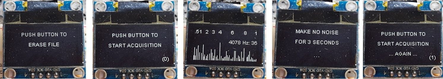

How to record yourself?
Create a folder called Acquisition_ESP32, and put the following files in it: Acquisition_ESP32.ino, functions.h, params.h
Load the sketch called Acquisition_ESP32.ino on your ESP32 and let it run. The sketch first searches for an already existing file in the ESP32's SPIFFS. If you do not want to keep the file, just push the button to erase it, otherwise, the recorded data will be appended to it (you have 3 seconds to push the button).
Then the sketch runs looping acquisition phases. To start such a phase, just push the button.
An acquisition phase is made of 2 parts: record snoring sounds, then record silence. The second part is as important as the first one, as it will enable the ESP32 to learn to recognize snoring sounds from the background sound. If you intend to use the detector at night, pay attention to record very low background at this moment.
The 2 parts last 3 seconds each. There is a 3 seconds delay in between. Each recording part will save 10 spectra in 16 frequency bands, plus one sound volume data, for a total of 20 * (16+1) = 340 data.
The OLED screen displays all instructions: push button to record (with the number of recording phases so far), make snoring sound, remain silent, etc.
When you decide to stop recording, just unplug the ESP32.
Change the parameters
During the recording phases, the OLED screen will display the variation of the sound spectrum. As I said above, the sound spectrum is divided into 16 sub-bands. This can be changed in the params.h file:
// Frequency bands #define BANDS 16
However, this number must be a power of 2, as required by the FFT functions. So you can increase it to 32, for a more accurate sampling, at the cost of a larger dataset and longer learning phase.
I recommend to run at least 20 or more acquisition phases, to provide a large dataset to the learning program.

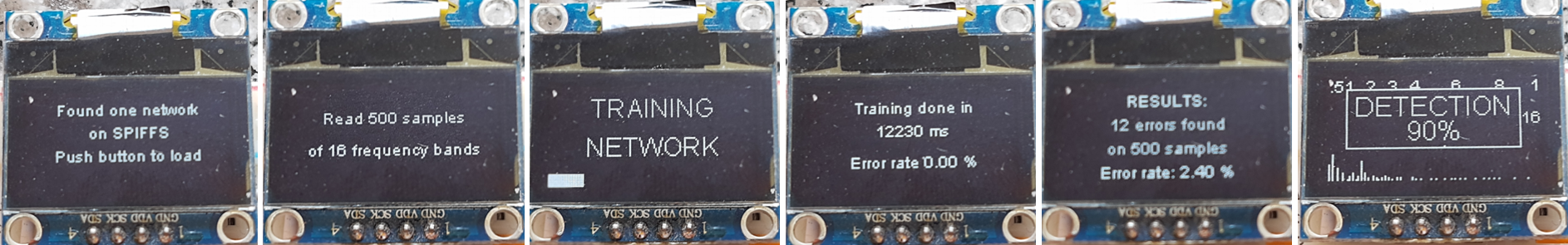

Upload the Learning_ESP32.ino sketch on your ESP32 and let it run. The OLED screen displays all the instructions.
It first looks for a saved network file. Of course, there is no such file if it is the first time you run this sketch. Otherwise, click the button (within 3 seconds) to load the saved network, and the learning phase will be skipped.
If you didn't push the button, the code launches the learning phase. This is an automatic process, made of the following steps:
- Read the dataset: the screen displays the summary of the content of the dataset file,
- Create a network and train it on the dataset: the screen displays a progress bar,
- When the training results are satisfying, depending on the parameters: the screen displays the learning results (number of errors, error rates).
- The network is saved in the SPIFFS, for later use.
- Then the program goes into the inference phase.

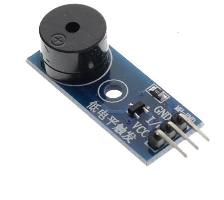

Back to the original idea: how to stop snoring? Well... your imagination is the limit. You can add a simple piezo buzzer on your breadboard to play annoying sounds when a snore is detected. Hopefully, this will disturb you enough to make you move on the side and stop snoring. But it may as well disturb whoever share your bedroom...
To do this, you need a piezo buzzer such as the one above and add a few lines of code in the Learning_ESP32 file...
First insert these lines before the setup, in the definition block:
const int buzzerPin = 18; // put here the GPIO number for the buzzer<br>int channel = 0; int resolution = 8;
The ESP32 handles the PWM a bit differently than the other Arduino boards: here we define the GPIO number connected to the IO of the buzzer, and choose a channel number and its resolution (in bits) for the PWM.
Then, place these lines at the beginning of the setup:
ledcAttachPin(buzzerPin, channel);<br> ledcSetup(channel, 255, resolution); int volume = 10; // 0 < volume < 255 ledcWrite(channel, volume);
This links the pin number to the channel, and defines the channel's properties.
