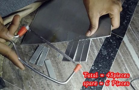

Step 1: MAKING & CUTTING STRIPS
we have make 48 PVC Strips inclucing spares by using PVC pipe. Just follow the procedure, and do follow as it is.
Cut the PVC pipe on a length of 60cm.

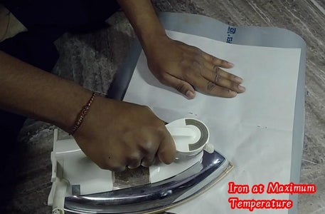

Cut in between the pipe to make pvc sheet and iron it by placing a paper.
Apply the heat again and again so the pipe becomes a perfect sheet.

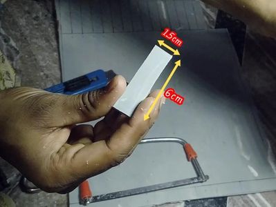

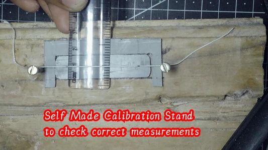

Then cut the PVC sheet into number of strips by the measurements below.
Length = 6cm
width = 1.5cm
total Strips required = 48 no's
Spare Strips = 5 no's

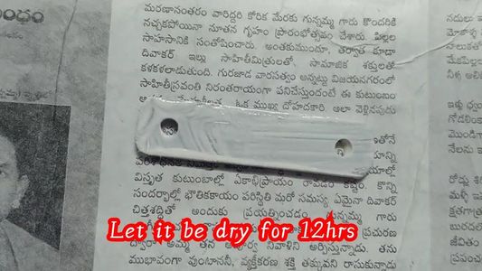

Step 4: Surface Finishing
To provide proper finishing or wood finishing on the strips at first we have to wipeout he dust formed on the strip surface. So follow these steps to make best finishing.

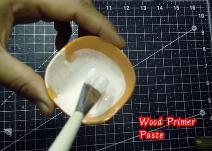

Step 1- Primer
Use the 80 grit sand paper and rub on the strip surface and move to 160 grit sand paper.
Do it the same process to the remaining strips.

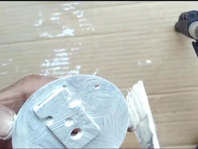

After rubbing, apply some wood primer on the strips using a paint brush.
Note that, the more thicker of primer the best finish we get.
Dry it for 12hours in open Air, ther is no need to keep it under the sun light.
After drying, and again rub the surface using 220 grit sand paper for all the strips and finally dedust it.

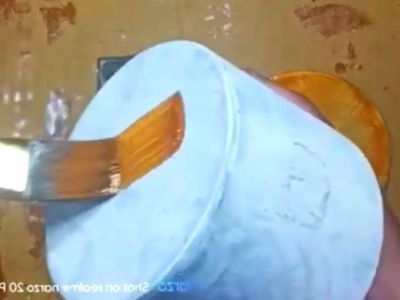

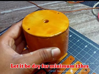

Step 2- Gloss Paint
  • I used the Gold Brown Gloss paint which looks really attractive and most available colour. Then apply the paint on the surface of the Strip using a paint brush. Let it dry for 12 hours.
Note: You should not touch the strips until it completely dries, otherwise the strip finish going to disturb.

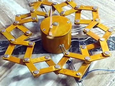

Step 5: Preparing Solticise Shape
  • Interconnect the strips one by one like chain process, and finallly make round loop of mechanism.
  • The strips are 20 degrees bends.
  • Apply the same sequence to form a chain like structure
  • finally join it in a loop.

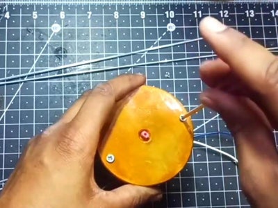

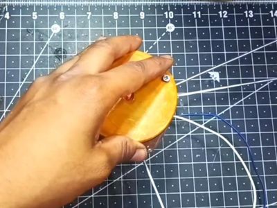

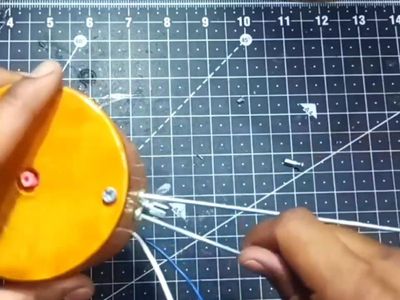

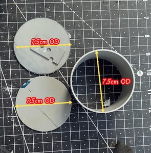

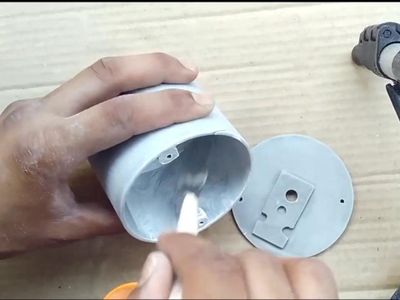

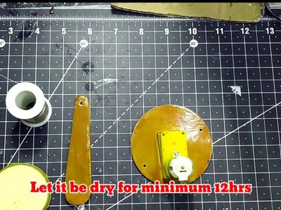

Step 6: Preparing Motor Guard
  • Please watch the video, for getting better clarity, and detailed process, because it has more images.

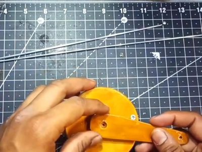

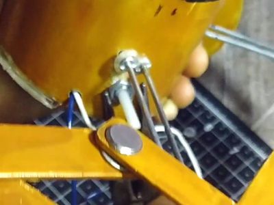

Step 8: Providing Hand Mechanism
After making the Solstice chain, we need to provide the contracting and expanding mechanism to the chain by applying some linear force. The linear force can be induced by using a rotating crank mechanism from a motor. This mechanism forwards the force to the chain by placing a small length of rod in between chain and crank means it works as a mediator which transfers linear force through it. The chain will be place on the cycle spokes at four different directions.
