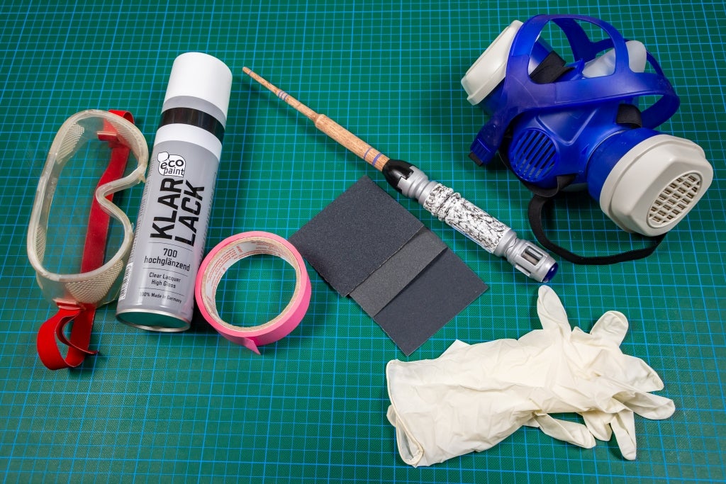

Safety Advice:
This instructable makes use of 3D printers, various power tools (optional) as well as super glue and epoxy resin. Super glue and epoxy resin are quite sticky and the fumes aren't good for your health, so take appropriate precautions. Work in well-ventilated areas and avoid skin contact in the latter case. Try not to glue your fingers to each other, don't be like me. Also, 3D printer hotends are quite hot, so please don't burn your fingers either.

Step 7: Painting (with a Bit of Sanding)
Painting:
Before I start let me remind you to use proper protective gear, especially a decent respirator / filter mask, as well as to work in a well-ventilated area. And if you're using a respirator mask and don't remember when you last changed your filters, this is your reminder to do it now.
With the rod acting as a painting handle I quickly made a stand out of cardboard and some tape to hold it in place for the paint to dry. Talking about the painting, my concept is masking the steel rod, then go for grey primer, black basecoat for the non-marble parts (masking the marble parts), silver for the metal-ish parts (keeping the marble parts masked, additionally masking the black front cap), finally a white basecoat for the marble part, all in that order. The rest will be done with acrylic paints. Let's see how it works out. At this point in time your guess is as good as mine.
For starters after two fairly heavy layers of grey primer the layer lines are still pretty apparent, so it's time for sanding. Again. After letting the paint dry (accelerated with a hair dryer) 180 grit sandpaper is used to sand the Sonic Wand once more. Two more heavy-ish layers of primer, some touch-up sanding with 320 grit sandpaper to follow. Finally about 3 or 4 more light layers of primer as a finish. It's not perfect, some of the layer lines and parts of the separation line can still be seen but as my time is running out I can't be too picky now. 'Good enough' will need to suffice. At this point I let the paint sit for an hour to fully dry / harden (and ventilate the premises properly) before applying masking tape and moving on to the next step: black basecoating.
There's nothing much to say at this time except for maybe to carefully apply the masking tape to get clean lines. Maybe using high-quality masking tape instead of the cheap stuff I've got at a discounter a couple of years ago. Oh, and whoever first thought to use a hair dryer to get paint to dry quicker was a bloody genious. I learned the trick from Adam Savage's videos on tested (website / youtube, very much worth a visit, especially the One Day Builds and Shop Tips). You can apply multiple paint layers so quickly with this method! No wonder modelmakers all around the world use this technique. To think I've spent so much time pretty much literally watching paint dry. No more!
Just be a bit careful with the hair dryer and PLA, don't dwell too long in one spot or get too close as you might either damage the paint or the print itself.
Anyway, layer and separation lines still show through, but with each layer of paint it gets better and most of it can be passed off as 'texture' by now. Hooray for me! I mean, just as planned! Next up is letting the paint fully dry for another hour, then super-carefully masking off the black cap part before moving on to silver paint for the metal parts.
The silver paint went pretty uneventful as well. More masking, more spraying, more drying. Not as shiny as it could be, but I didn't have any high-quality chrome paint at hand and learning from the solidified resin fiasco I kind of want to use up what I have first. Plus, for a really shiny chrome finish you need an expertly prepared surface as well, meaning it has to be suuuper smooth (which mine isn't) with good basecoats. If you're interested, Bill Doran from Punished Props has an article of chroming parts with Allclad Lacquer on Tested, which is apparently industry-leading or something. Adam Savage on the other hand swears on Molotow Liquid Chrome, which he also uses in his video on Tested: "Adam Savage's One Day Builds: Mortal Engines Hand Cannon!" where he finishes a 3D-printed prop firearm.
Next one's going to be interesting as I'll have to peel off the current masking and apply new ones.
The peeling went pretty well, only minor chipout and paint creep under the masking tape. Nothing that can't be touched up later with acrylic paints. New tape was applied to mask off the non-marble-parts and white base paint was used to create a base for the marbling, which I already dread as my painting skills are quite underdeveloped and marbling is fairly ambitious for me. By the way, in the picture below it looks grey-ish, but that's because the paint isn't quite dry yet. It really is white as you'll see a bit later.
That went unexpectedly well. All the masking tape peeled off without any problems, and the layers upon layers of paint are thick enough to almost completely mask any remaining layer lines of the 3D print as well as the separation line of the halves. I specifically focused on the separation line in the picture below, and there's only a few places where you can see it. If you don't exactly know what to look for, it's not noticeable. In order to protect the sprayed paint before moving on to acrylics I gave the whole Sonic Screwdriver two or three light layers of spray-on varnish. It also helps when wiping off excess acrylic paint either wet or dry without damaging the spray-painted paint layers. Now it's time to do the marbling, the detailing and maybe some very light weathering. We'll see.
Damn, I only noticed the reflection of my lighting umbrella on the acrylic painting palette in editing. Oh well, now you know how I get soft lighting on my pictures: Shoot-through umbrellas. Not quite as good as softboxes, but a heck of a lot cheaper and typically quicker to set up, too. At the same time I noticed that I had flipped my cutting mat to the black side instead of my usual green - what a blunder. Either it's getting too late (I'm writing this at 1am to make the deadline) or the paint fumes had gotten to me. Oh and you don't need this many brushes, in fact I only used two of them - a very fine-tipped one for details, and a rather fine flathead one. I don't quite remember if it was the left or the middle one of the trio you can see here. But they are decent-quality synthetic brushes, which makes things a lot easier.
First of all I removed the masking tape of the exposed steel rod part. Then I moved on with some touch-ups on the silver and black parts that were either scratched up or not colored properly. The zig-zag channel of the extendable part (of the real Sonic Screwdriver, mine doesn't move) was filled in with some black paint using a very fine brush, as was the channel for the push-button-thingy at the side. The other side channel was colored light blue, similar to the original prop. Finally it came down to marbling. I used Snobs Interiors: "Grey Marble Effect" as a reference, as well as some images, but in the end I just added black lines of various widths with a fine brush and after a varying amount of fairly short drying time I dabbed or wiped over it with a dry or slightly damp piece of kitchen paper. This process was repeated until I ended up with something which from a distance and while squinting and being almost blind just might resemble marble. Being pretty much done with the detailing I'm fairly satisfied (rad: I've passed the 'Good enough!' threshold) so I think I'll be skipping any weathering and move on to the assembly.
