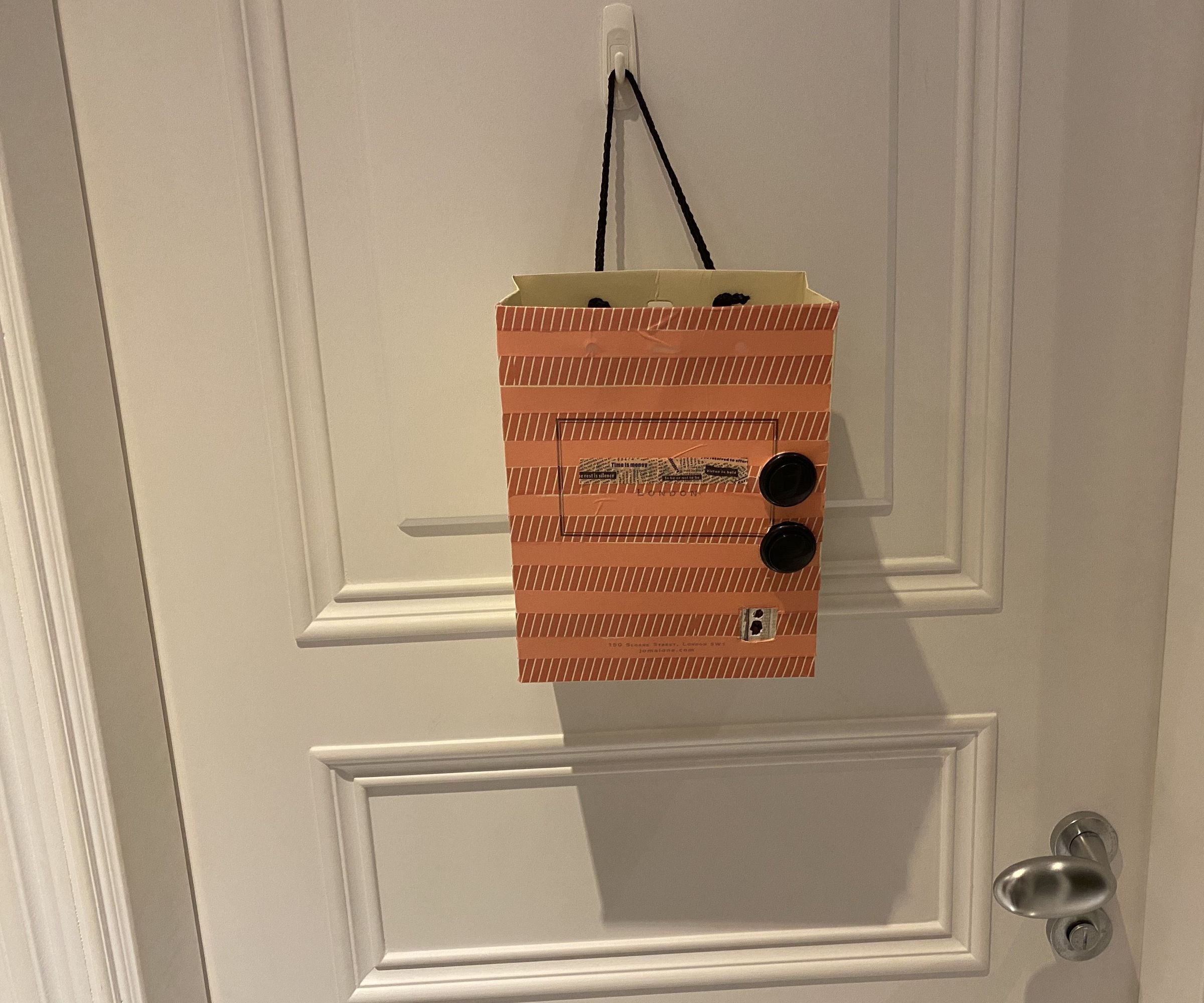

Introduction: Sound Traffic Light
It is a traffic light that will make sound when the traffic light change. I use to connect with Arduino.

Step 5: Step4: the Sound Traffic Light
It is a video that shows the making progress, step and how it runs
please click here
