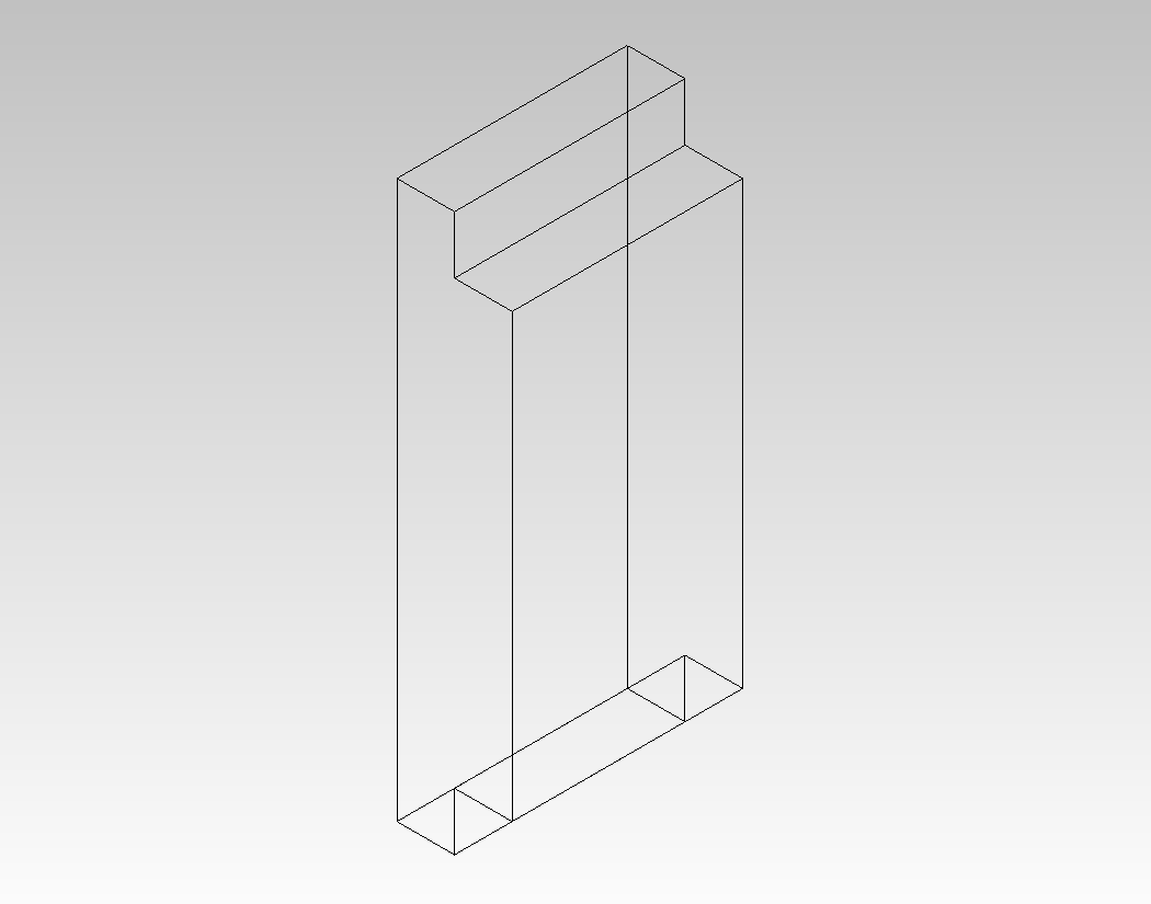

Step 2: Cut Rabbets
Cut your boards to length. The length of these boards will vary depending on the size of your spark plug. I cut mine to 3 5/8 inch and that allowed for enough space for my 3 1/4 inch spark plug to fit (with clearance hole made in the next step).
Cut rabbets in the ends of three of your pieces. I used a flat tooth table saw blade for this, but a router or dado stack would work just as well.
Rabbets should be exactly half the thickness of each board both in height and depth.

Great DIY puzzle! The choice to use a sparkplug is interesting and walnut was a great choice! I've never utilized a Rabbet joint before, so how would you cut that? Also, would it be safe to make the walls a little thinner than 3/4"?
0
tomatoskins
tomatoskins
Reply 5 years ago
I made my rabbets by taking multiple passes on the table saw with a flat tooth blade. If you don't have a table saw, you can also make them with a flat router bit on a router table.
