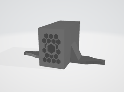

The first important thing to know is, that I didn't start from scratch. It was an unfinished project from another student. My job was in the first place to understand how all the parts of the drone work and secondly, make the drone work. So for the first step, I had to unscrew every part and understand what it did. After I did that, I had to put everything back together, but before I did that, I wanted to change some parts on the drone, because I didn't like the designs and colors used on the drone. I wanted a sleak but simple design, so I redesigned some parts and 3D-printed it. Some parts didn't fit immediately, but after making some small changes, everything fell into place. The parts used in this build are some of the best components you can get on the market. A powerful processor and high-performance sensors.

During the designing and building of my SpeedyBee F7 V2 drone, I made use of various 3D design tools to create new components. I wanted to improve the drone's stability, so I decided to position the battery underneath it. I designed a special holder to hold the battery.
