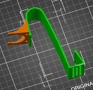

To avoid printing supports, there are 2 STL files the Sponge holder for a CURVED (or Square) sink and a second for the Detergent bottle. They are super-glued together to avoid slicer supports.
Slice the STL files:
  • SpongeHolderCurved.stl (or SpongeHolderSquare.stl)
  • SoapBottleHolder.stl
3D print the files. .2mm layer height and other parameters that work on your 3D printer.
Super-glue the SoapBottleHolder to the SpongeHolder.
To avoid gluing (slicer supports recommended)---
  • Use the SinglePrint.stl for curved sinks.
  • The right image above shows the combined stl files for a single print.
  • The slicer should be able to combine both stl files for a single full print (supports suggested).
  • Combine SpongeHolderSquare.stl and a rotated SoapBottleHolder.stl if needed.
  • The angle needed to mate the 2 stl pieces is about 11 degrees.
