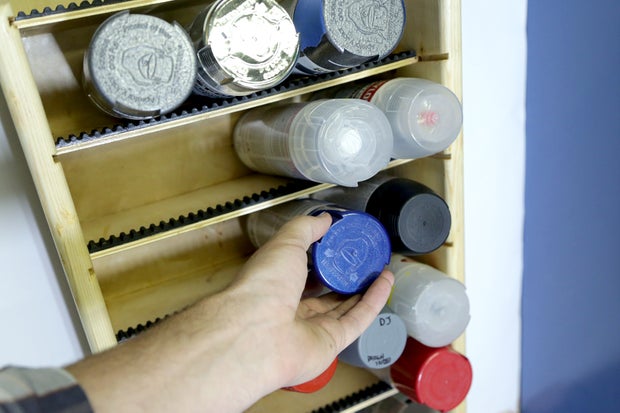

I keep all my spray paint on a shelf in the workshop. This is usually fine, until I need a spray can way in the back and knock over all the cans in front trying to grab for the one I want. Instead of taking up a lot of valuable shelf space I moved my spray cans to a wall mounted system which allows me to see what paints I have at a glance.
This wall mounted spray paint shelf was really easy to make and is a colourful addition to my space, all while keeping my space organized. Making your own is easy and can be customized or partitioned to accommodate any cans you might have in your workshop. 1..2..3..Let's make!

I chose to router the edges of my shelving to give it a smoother and more finished appearance. I chose a 1/4" roundover bit. I worked the edges on the front and back, as well as the top, leaving the inside edges and the bottom untouched.

Step 10: Roll Prevention
To prevent the cans from rolling around on the shelves I installed a roll strip. That way when one can is removed from the shelf and accidentally knocks another can it won't go rolling around. To achieve this I used a timing belt cut into sections the same length as the shelves.
Step 11: Installing Roll Strip
The cut roll strips were installed on the edge of each shelf. To attach the strips I used a rubber cement. Cement was applied to the shelf edge and the the flat side of each roll strip and allowed to dry completely.
After about 10 minutes the rubber cement was completely dry and the strips could be pressed onto the shelf. To ensure a secure bond I used some clamps to hold each strip down for a few minutes. You only really get one chance to apply the strips with this cement, to take your time and ensure the strips are applied straight.

All that's left is to install your paint rack somewhere accessible for your space and fill up your paint rack with your spray cans.
