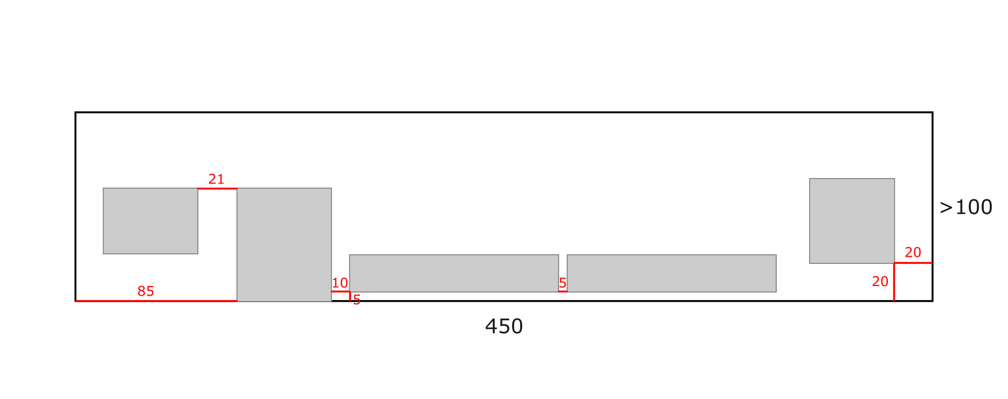

- Wood board for a base (minimal size - 450x100mm)

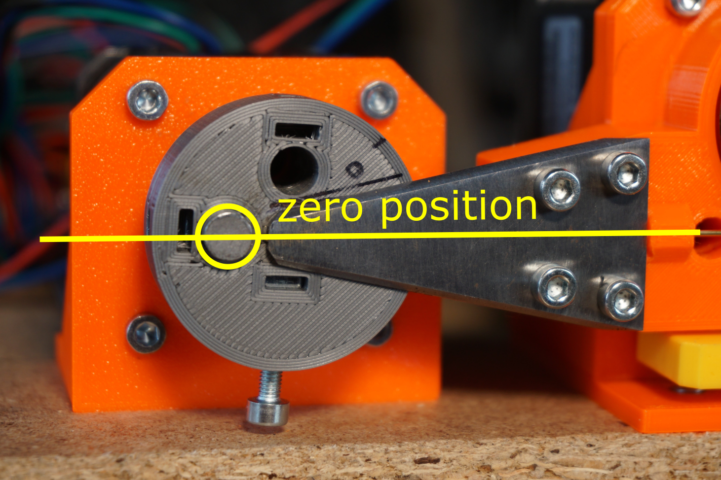

Setting bender head Zero position
Movement of a bending head is defined from a well-known fixed position of the bending head. In my case, it is the position where the bending pin on the head is facing left. See the picture below. It's wise to mark this zero position on the head to be able to reset the head to the very same position. There is no such need for defining zero position for feeding gear because it always moves relative to the current position.
