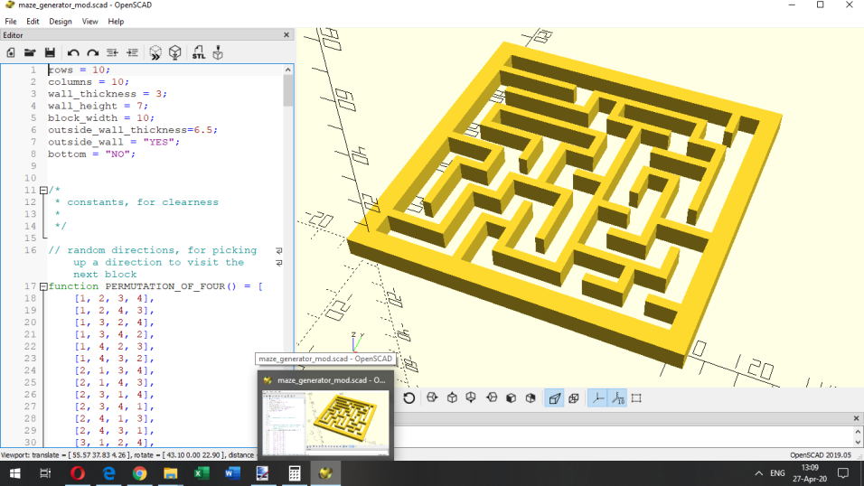

It is difficult and time consuming to design, to manually draw a maze. That's why I used a software solution to generate them. I’m gaining time in this way, I can set different values for the maze generation and the result is an STL file that can be printed directly on the 3D printer. For this I use a script that can be run in OpenSCAD.
OpenSCAD is a software for creating 3D CAD models, it is free and is available for Windows, Linux and Mac. OpenSCAD is not an interactive design software but a compiler that reads the contents of a script file that describes the object and then OpenSCAD renders the 3D model as described in the script file. This gives the user complete control over the 3D modeling and allows changing any step in the process. Also, it is possible to carry out projects that are defined by configurable parameters.
The script I used is a slightly modified version of JustinSDK's maze generator which you can find on Thingiverse. He also has a large collection of very interesting maze generators, that you can find on github. Worth a look.
So, I downloaded the OpenSCAD installation kit, I installed it, I opened the maze_generator_mod.scad script (it is attached below just change extension to *.scad).
Clicking on the render button I can generate different mazes
that I can save by pressing the STL button .
A few remarks on the script.
The only change I made to the original script was to add an exterior wall that has two purposes: to strengthen and close the printed structure of the maze and to hide the entrance and exit of the maze. If you give up the outer wall (outside_wall = “NO” or outside_wall_thickness = 0) then the generated maze is the one in Justin's original script.
With the initial values in the attached script, the size of the maze is 110mm x 110mm and the thickness is 7mm.
