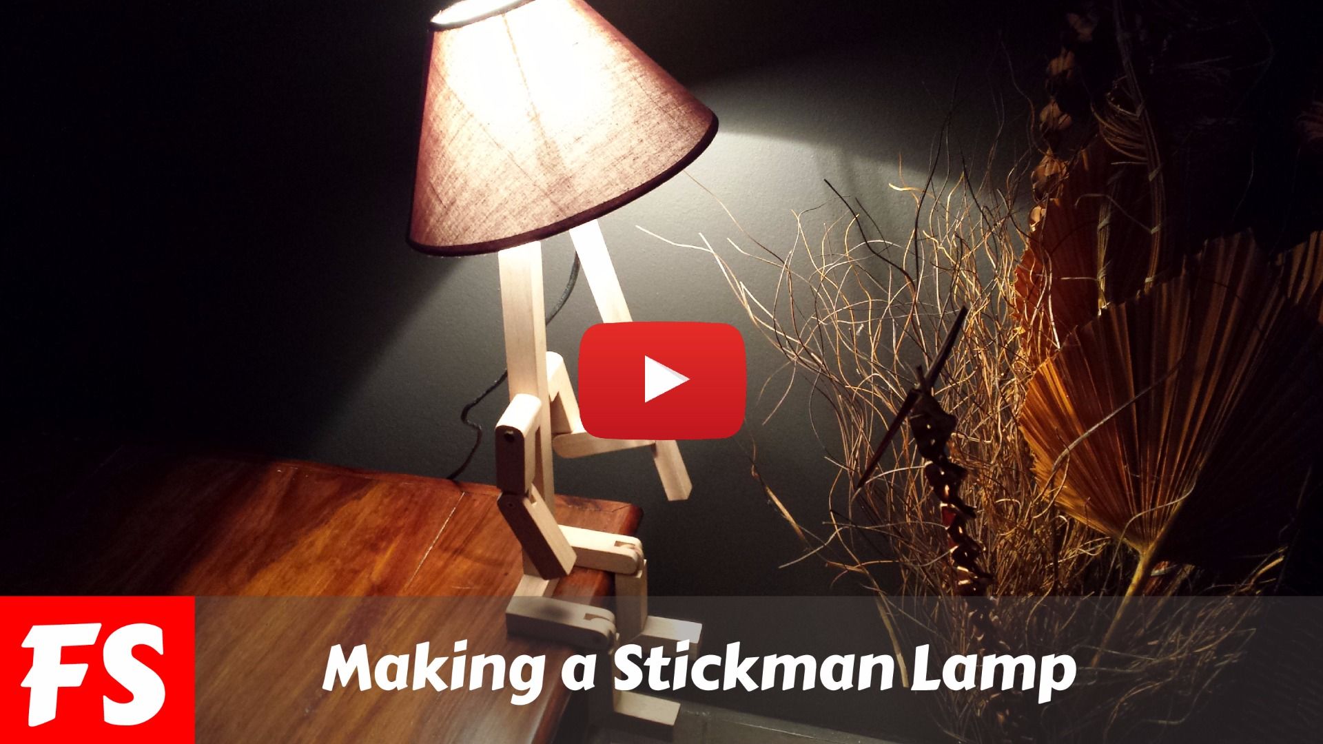

Introduction: "Stickman" Bedside Lamp
Our bedside lamp is probably the first thing we see in the morning and definitely the last thing we see at night. So, why not make a fun and pretty one?

Here is a video of the building process, and below you will also find a full scale pdf file with plans and dimensions.

Take a few strips and mark 2.1 cm from the edge. On the band saw cut the mortises and tenons as shown in the video (Images 1 and 2), or you can use a hand saw and a chisel for it.

Step 7: Finishing
Glue the shaft to stickmans hand. Connect the wires and fit the lampshade.
Its all done!
Have fun.
