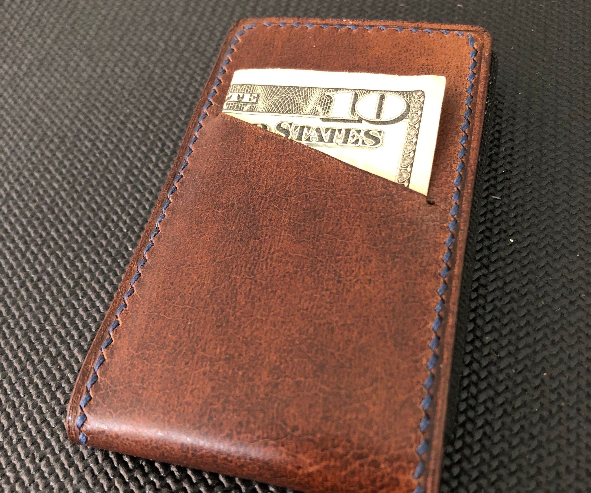

Step 1: Cut Your Pieces
- Figure out how big you want your coaster
- Cut 2 pieces of leather with one slighter larger than the other.(I do this because I would prefer to trim off excess, rather than line up the edges perfectly )
Step 2: Glue and Trim
- Apply glue to the smaller piece
- Make sure to have good coverage along the edge of the piece, you don't want your coaster to spit or fray down the line
- After glue has dried, trim off the excess
Step 3: Round Corners
- I think round corners give the coaster a much more finished look so
- Get something to help you draw a round corner, a quarter till do just fine
- And cut on the line you drew
- Rather than making one big curved cut I make small straight cuts taking off a little bit at a time, sort of like cutting your nails
Step 4: Sand Your Edges
- Give your edges a quick sand to smooth out the edges
Step 5: Bevel Edges
- Use an edge beveler to bevel your edges
- I also used sand paper to bevel areas that were harder to bevel such as the rounded corners
Step 6: Mark Stitching Line
- Using a wing divider mark your stitching line
- I set my wing divider to 3mm
Step 7: Punch Your Stitching Holes
- Following the stitching line you just marked, punch out your stitching holes
- Making sure your prickling iron is perpendicular will ensure that the holes are aligned on the back side
Step 8: Stitch
- Stitch your piece together
- If you have a stitching pony, it will make this process alot quicker
- When you made to the end, cut your thread and singe
Step 9: Done
- You can do any sort of touch up you like but essentially you are done!
