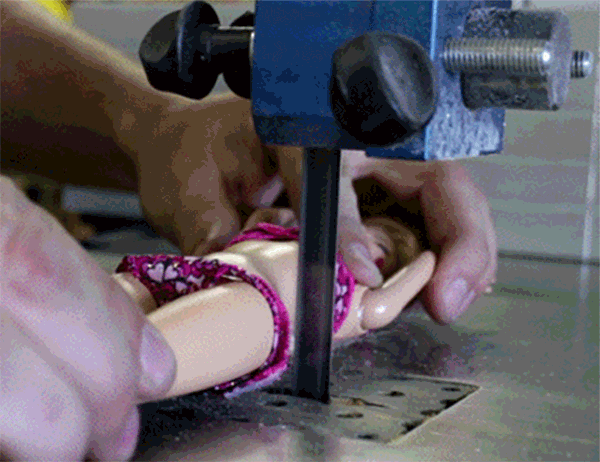

Step 2: Slice Barbie
To get to the insides of Barbie we'll need to bisect her plastic body. I carefully sawed Barbie in half at her waistline.
After sawing through the edges of the cut were cleaned of any burrs.
